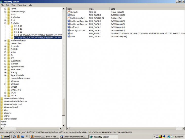

I had the same problem this morning and found your posting.
I went to where you pointed in the Registry but after getting to the ProfileList I lost you.
I hate to be so dumb but could you perhaps provide a screen shot or more detail on what exactly I should delete?
Thanks.

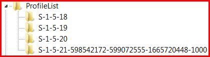

#5
I assume you got as far as this (see attached). you then need to open each file (e.g. HKEY_LOCAL_MACHINE\SOFTWARE\Microsoft\Windows NT\CurrentVersion\ProfileList\S-1-5-21-598542172-599072555-1665720448-1000, in my example) and check to see that the ProfileImagePath makes sense (i.e. it points to an actual user profile, not some spurious name). I don't know how these spurious keys get created, but you simply have to delete any keys with spurious ProfileImagePaths. It is best to make a copy (on, say Desktop) of all files in the ProfileList before you delete any, in case you delete a valid one (as I did first of all):rolleyes:

#6
Thanks for the help. I tried the ones on my PC (the first three). The S-1-5-18, 19 & 20.
That must not be the ones.
I'm afraid to mess around too much. I've tried to do an attachment. Couldn't figure out how to reduce it and it still be readable?
