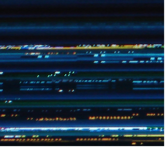

After pressing FINISH button a pop-up appeared which asked me to restart the machine.
After I restarted my machine and logged in in few seconds the screen turned blank. Kindly look at the attached image file. I waited for 1.5 hours but it remained as it is and then I switched off my machine by pressing power button.

And richard sir did you get to see how my screen turned after running the verifier as you suggested(Post Number#4).

That is how the verifier works. If you have a bad driver it will or should generate a new dump, so the drivers can be verified. It will turn off or give a BSOD.
