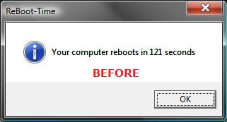

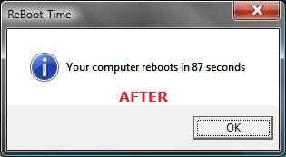

EXAMPLE: Boot Up Time Before and After
NOTE:
This is the before and after boot up time for my computer after I changed it to use all 4 cores. For fun you can post your results here: ReBoot Time

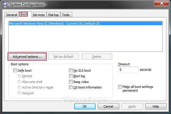

4. Click on the Boot tab. (See screenshot below)​
5. Click on the Advanced options button.​

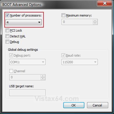

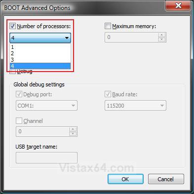

6. To Change the Number of Processors at Boot -
A) Check the Number of processors box, then click on the drop down arrow and select the number of available processors (cores or CPUs) you want to have used at boot up. (See screenshots below step 7)​
NOTE: To test to see if this can speed up your boot time or not, then select the highest number listed for all of the available processors to be used at boot up and check the Detect Hal box.​
B) Click on OK.​

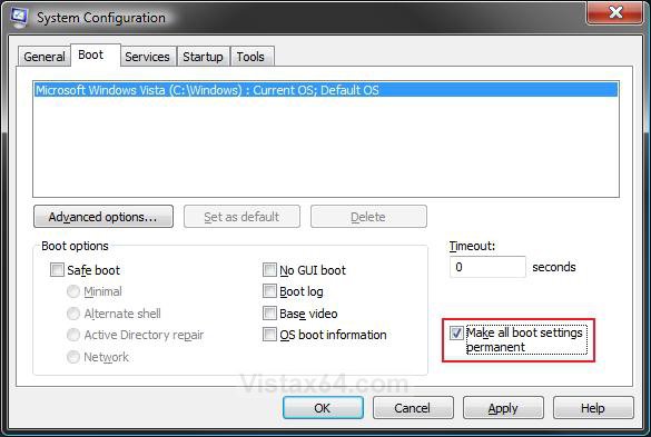

8. Check the Make all boot settings permanent box and click on OK. (See screenshot below)​
NOTE: If you do not check this, then you will Selective startup dotted instead of Normal startup under the General tab. You can still make changes again by checking this again after any changes.​

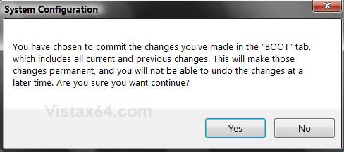

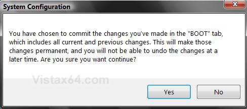

9. Click on Yes at the confirmation window. (See screenshot below)​
NOTE: You can restore or make changes to this again later if you want. I will confirm it. Just remember or write down what you had set (checked or unchecked) before if you wanted to restore back to those settings later.

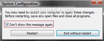

10. Check the Don't show this message again box. (See screenshot below step 11)​
NOTE: You will not see this again after checked.
11. Click on the Restart button.​
NOTE: If you checked the box and want to restore this Restart box, see: How to Restore the System Configuration Restart Prompt in Vista
WARNING: This will restart the computer immediately. Make sure you save and close anything open you do not want to lose.
