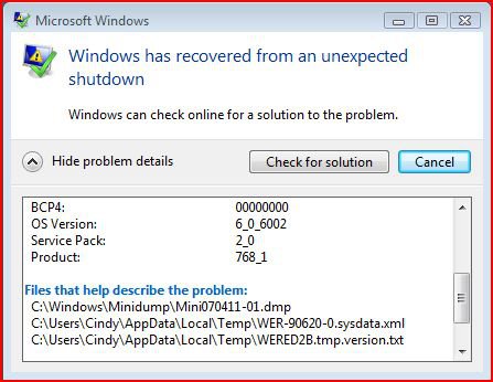

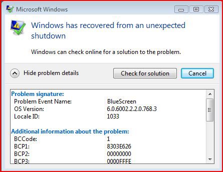

When I booted my computer this morning it again gave me the BSOD. I selected to start normally from the next screen and that went ok -- except the screen did flash to white for a few seconds after the desktop loaded, which is not normal.
Probably you only got the most recent mini dump because I run CCleaner a few times a week. Please see the screenshot of what I have checked for cleaning under System and tell me what I should uncheck in order to maintain the mini dump info.
Also see the screen shots I took this morning of the Windows info box that appeared explaining the BSOD of this morning.

Nikilet
Do I need to know about this driver verifier -- for instance, how did I inadvertently turn it on?
I did not get a BSOD on restart, but after my desktop had come up and was loading, the screen again turned all white for approximately 10-15 seconds. I know it should not be doing this.

Lets try to get the BSODs fixed. The problems could be related.
I cannot tell you how the Verifier got turned on. Maybe someone was trying to fix your computer, family member or you brought it to a pro. Possibly, if the OS came with the computer, the computer manufacturer turned it on. I really cant answer more definitively.

You know as much as I do. Dont worry about the verifier, the computer probably came with it on. It does not cause problems, it merely makes bad drivers BSOD.
Night.
Just give Avast the name of the driver and that it caused at least 3 BSODs.
Then see what they say
If they tell you how to fix it and it works great, good luck
If they tell you how to fix it and you still get BSODs from the same driver, you must get rid of Avast.
I and other members will be here for you. To help you in the future
