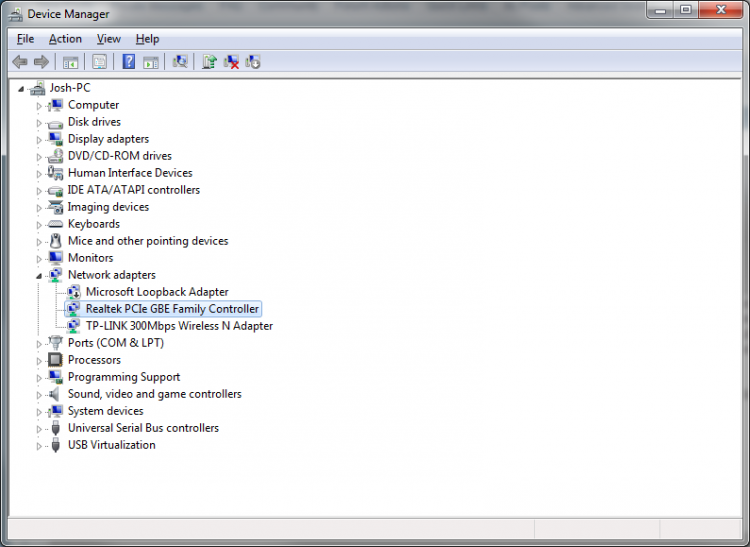

You are correct in saying that the NIC won't pick up the cable. It is reporting as media disconnected. Your setup maybe different but I would first try and uninstall the NIC driver in device manager. It should be under network adapters for you. To do so, just simply right click the NIC and click uninstall. DO NOT UNINSTALL YOUR WIRELESS NIC. Doing so will completely cut out your internet connection and may not restore it. If you are unsure simply send us a snip of your device manager and we should be able to suggest the appropriate device to reinstall.
To find device manager, follow this tutorial up to step 5 only - http://www.vistax64.com/tutorials/193584-device-manager-install-driver.html
A sample picture of mine:

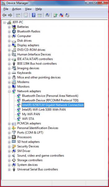

The highlighted device is my guess. The three below it all say WiFi (wireless) and the two above it are for BlueTooth (which I have probably never ever used on this machine -- or anywhere).
The device under PCMCIA adapters had "controller" in the name and sounded too ominous to uninstall and nothing else really strikes me as network related. (Also, I now notice your image showing the Network Adapters part of the tree).
You've been exceptionally helpful and patient with me. More patient than I am -- if I don't hear back soon, I will probably just blow that one away and let it reinstall.
I uninstalled the highlighted driver and restarted my PC. It reinstalled the driver and I rebooted a second time (for good measure). I ran ipconfig again and got pretty much the same results as 3 posts ago.
Is my NIC card dead? Is that the problem?
