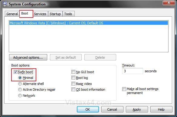

2. Run msconfig (step 1 in METHOD TWO at link), and click on the Boot
tab and click on Safe boot with the minimal button selected. (See screenshot below)​
3. Restart the computer to hopefully have chkdsk run.​
4. Set msconfig (step 2 in METHOD TWO at link) to boot normally again.​
5. If chkdsk still will not run at startup, then proceed with the steps below. If it did, then you're done.​

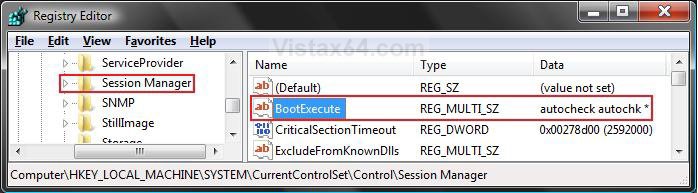

4. In regedit, go to: (See screenshot below step 5)​
HKEY_LOCAL_MACHINE\SYSTEM\CurrentControlSet\Control\Session Manager

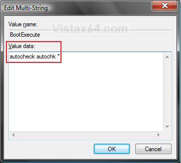

5. In the right pane, right click on BootExecute and click on Modify.​
6. Type autocheck autochk * and click on OK. (See screenshot below)​
NOTE: You will be replacing autocheck autochk /p \??\C: with autocheck autochk* instead. If BootExecute already has a Data value of autocheck autochk *, then you do not need to do this. Go to STEP THREE below.​

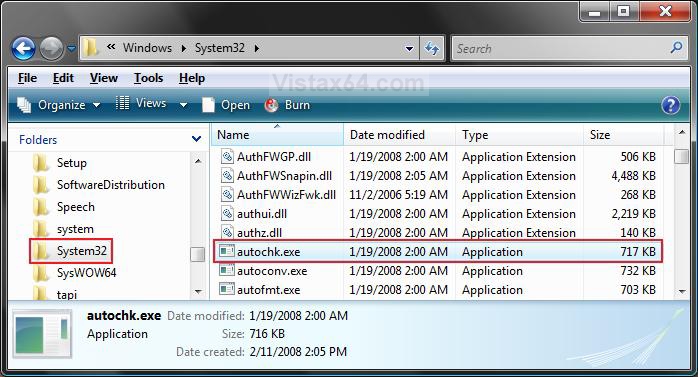

2. In Windows Explorer, go to C:\Windows\System32\autochk.exe. (See screenshot below)​
3. Take ownership of the file autochk.exe at the C:\Windows\System32\autochk.exe location, and "Allow" your user account "Full Control" of it. (See screenshot above)​

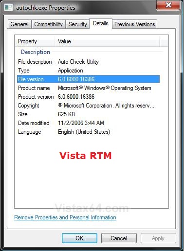

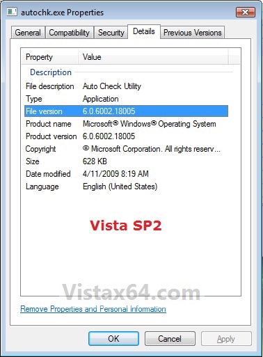

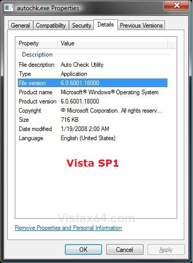

5. Click on the Details tab. (See screenshots below)​
A) Make note of what File version the autochk.exe file is.​
NOTE: If the File version is blank or you have SP1 installed, then do step 6. If not, then do step 8.​
6. Download the same version that you have in step 5.​
7. For the Vista 6.0.6002.18005 SP2 Version of autochk.exe

9. For the Vista 6.0.6000.16386 RTM Version of autochk.exe
NOTE: This is for the 32 bit and 64 bit Vista without SP1 or SP2 installed. This version has been reported to still work with or without SP1 installed, so you may try it if you still have problems with the newer 6.0.6001.18000 SP1 or 6.0.6002.18005 SP2 version.​

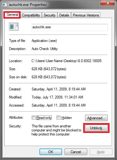

13. Right click on the autochk.exe file on your desktop and click on Properties and the Unblock button under the General tab. (See screenshot below)​
NOTE: If you do not have the Unblock button, then it is already unblocked. Continue on to step 14.​

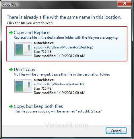

14. Right click on the autochk.exe file on your desktop and click on Copy.​
15. Go back to the Windows Explore window at C:\Windows\System32\autochk.exe. (See screenshot below step 2)​
16. Right click on a empty space in the Windows Explorer window and click on Paste. (See screenshot below step 2)​

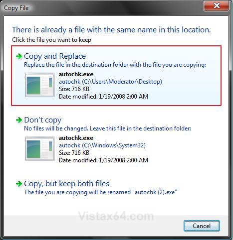

NOTE: If it will not let you Copy or Paste the new autochk.exe file (on desktop) over, then rename the old one and repeat step 14, then delete the old renamed autochk.exe file afterwards.​
17. Click on Copy and Replace. (See screenshot below)​
NOTE: This replaces your autochk.exe with the downloaded clean one on the desktop that has not been taken ownership of.​
