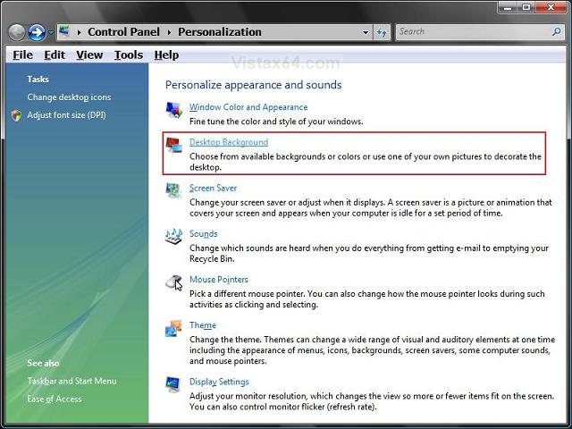

Remove or Show the Desktop Background Option

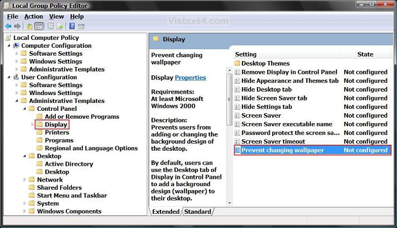

STEP ONE will just remove the Desktop Background option from the Personalize appearance and sounds screen. Users will still be able to change the wallpaper by right clicking on a image and click Set as Desktop Background. You must also do STEP TWO below to prevent the desktop background from being changed.
2. In the left pane, click on User Configuration, Administrative Templates, Control Panel, and Display.​
(See screenshot below)​

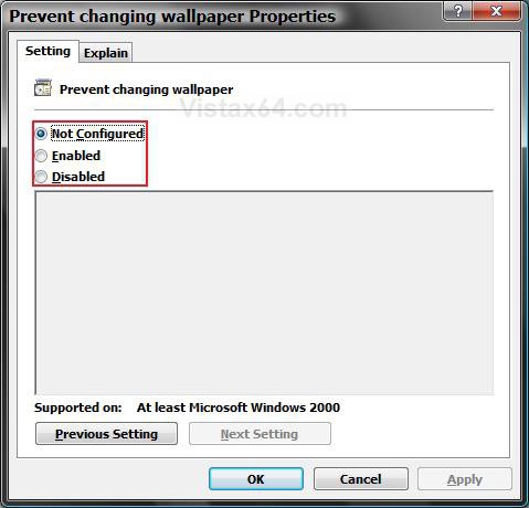

3. In the right pane, right click on Prevent changing wallpaper and click on Properties. (See screenshot above)​
4. To Show the Desktop Background Option
5. To Remove the Desktop Background Option

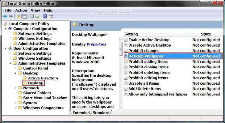

6. In the left pane, click on User Configuration, Administrative Templates, Desktop, and Desktop.​
7. In the right pane, right click on Desktop Wallpaper and click Properties.​
8. To Enable Changing Desktop Background
A) Select (dot) Disabled or Not Configured and click on OK. (See screenshot below step 9D)​
B) Go to step 10.​

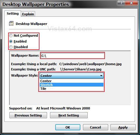

9. To Disable Changing Desktop Background
A) Select (dot) Enabled. (See screenshot below step 9D)​
B) In the Wallpaper Name: box, type in the full path of a wallpaper you want displayed for all user accounts. (See screenshot below step 9D)​
NOTE: You can only use a .BMP or .JPG image. If you just want a blank wallpaper, you can enter a invalid path. (EX: C:\ )
C) In the Wallpaper Style: box, select if you want the wallpaper to be in Center, Stretch, or Tile style. (See screenshot below step 9D)​
D) Click on OK. (See screenshot below)​

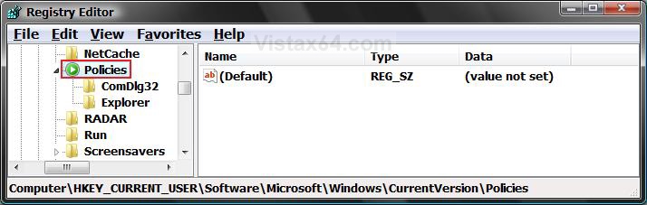

Manually in Registry Editor
1. Open the Start Menu.​
3. If prompted, click on the Continue button in the UAC prompt.​
HKEY_CURRENT_USER\Software\Microsoft\Windows\CurrentVersion\Policies

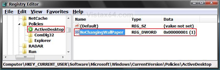

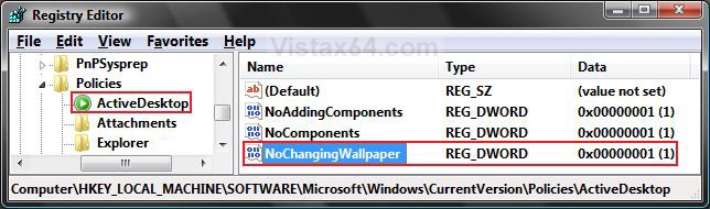

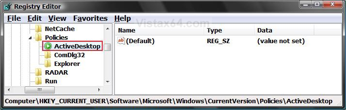

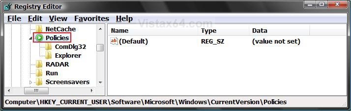

A) In the left pane, right click on Policies and click on New and Key. (See screenshot below step 4)​
NOTE: If you already have the ActiveDesktop key, then go to step 5C.​
B) Type ActiveDesktop and press Enter. (See screenshot below)​

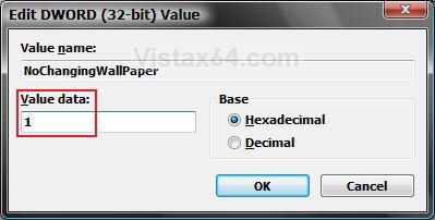

C) In the right pane, right click on a empty area and click on New and DWORD (32 bit) Value.​
D) Type NoChangingWallpaper and press Enter. (See screenshot below)​
E) In the right pane, right click on NoChangingWallpaper and click on Modify.​
F) Type 1 and click on OK. (See screenshot below)​

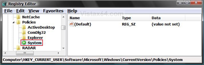

7. To Disable Changing the Desktop Background

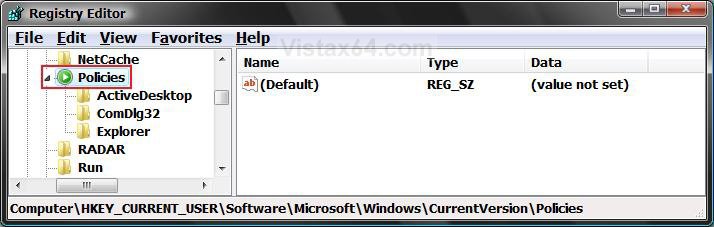

A) In the left pane, right click on Policies and click on New and Key. (See screenshot below)​
NOTE: If you already have the System key, then go to step 7C.​
B) Type System and press Enter. (See screenshot below)​

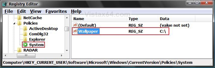

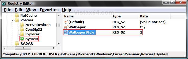

C) In the right pane, right click on a empty area and click on New and String Value.​
D) Type Wallpaper and press Enter. (See screenshot below)​

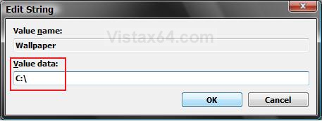

E) In the right pane, right click on Wallpaper and click on Modify.​
F) Type in the full path of a wallpaper you want displayed for all user accounts and click on OK. (See screenshot below)​

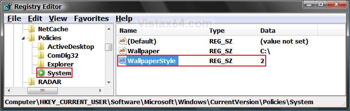

G) In the right pane, right click on a empty area and click on New and String Value. (See screenshot below)​
H) Type WallpaperStyle and press Enter.​

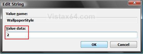

I) In the right pane, right click on WallpaperStyle and click on Modify.​
J) Type in a number below in bold for the wallpaper to be in Center, Stretch, or Tile style, and click on OK. (See screenshot below)​
  • Type 0 to Center the wallpaper on the desktop.
  • Type 1 to Tile the wallpaper on the desktop.
  • Type 2 to Stretch the wallpaper to fit the desktop.
