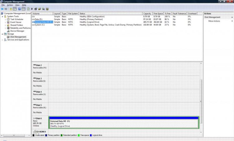

Hi Lorien
Thanks for your reply and advice. I have been away for 4 days and PC has been off, used a couple of times without external drive powered up. Read your reply and statred to apply it; F drive working ok on "Firewire" connection managed to run the "Vista" checkdisk tool from "Drive" properties it processed both parts sererately and to end and returned "no errors" messagess and "clean bill of health" on drive files and sectors?????? Attached is screen shot of " Drive Management" listing showing a healthy F drive this is the best performance I have had out of it for weeks.
I am sure this is some sort of "Software Issue" but what could it be??
Best Regards John

Drives are broken into blocks which group together to form clusters which group together to form sectors. It checks them individually and as groups for errors and fixes whatever it finds - perhaps it fixed something by doing the process that may be why it's running a bit better.
That screenshot looks fine - though the drive seems to be getting a bit full (and that can affect performance and if it gets too much closer to 100% then eventually you won't be able to deframent and start having other issues as it really needs a bit of free space to operate properly).
I've no idea what the software issue might be (assuming it isn't a hardware or driver issue - with the drive OR with the computer) - it could be a Windows update or some other update or some type of system file corruption or it could be something changed in your system configuration without you wanting it to. That's why I suggested the System Restore. It doesn't affect your data, but returns you to the condition you were in before the problem started and hopefully that might solve the problem. I plan to suggest other tests and procedures if that one didn't work.
But if it's working fine now, maybe we should leave well enough alone. On the other hand, if you mean better but still not good enough, then start with the System Restore to see if that helps. If not, we'll move on from there.
