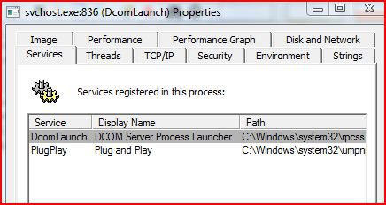

Can you try doing this? (The Process Explorer option)
How to determine what services are running under a SVCHOST.EXE process
Then upload a screenshot of the services that are running under svchost.exe for us please :) Something like this:

I've enclosed the results of synchost.exe

That screenshot looks normal to me :)
