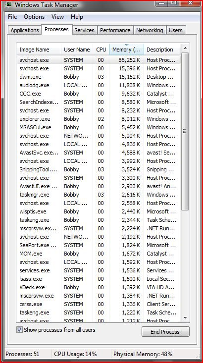

My memory usage is at 50% when no programs are running. I just downloaded several updates and I'm not sure if that has to do with it, but restarting after the updates was unusual and restarting generally now seems to take longer as if there's a delay in the process of getting to the sign-in screen.
I don't tend to look at my memory usage but I did a month ago in checking my virus scan. During that scan my memory usage was essentially flat at 500 MB or 25%.
Thanks
Added a shot of processes of all users while idle.
About 2.5 hours after posting I closed the installed programs window I was looking at and saw the desktop icons kind of flicker. I checked my memory usage at idle and it was down to 38%.
Restarted, back to 50%.

The ones at the top of the memory hog list are svchost.exe. You need to right click and select Go To Services. TM will then show you which service it is running. If those are related to the updates then you are probably right.
But as Rich says, the quick fix is to run a Restore Point from before the update. Update should have made one before it started making any changes to your system.
Also you might look through the updates and see what they are for. If a particular one is for a system you don't use, it may be all downside and no upside installing it. The more variables in the equation the more permutations you have to go through to weed out the bad updates. It uses quite a bit of time if you have installed say, 1/2 fixes in one shot. I prefer to put on a Service Pack or just an individual fix I know I need, rather than just whatever is issued that week.

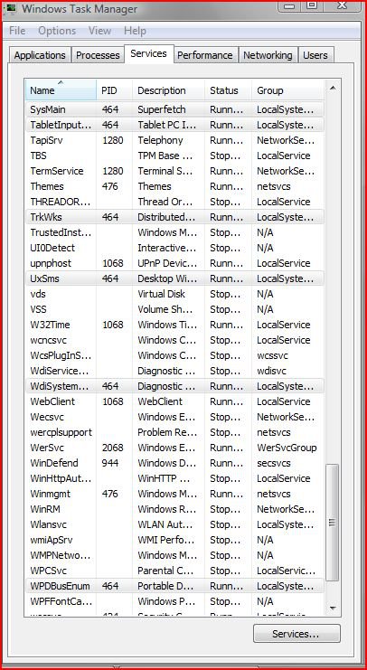

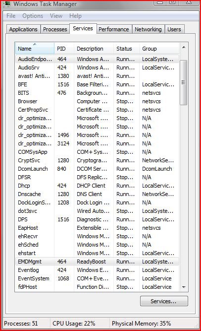

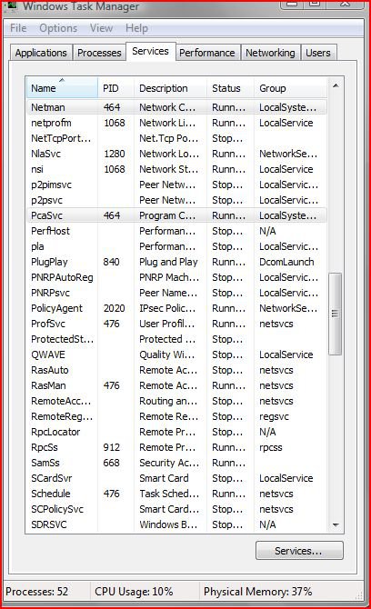

I just woke my pc from sleep and the idle usage is at 35%. I did what Miles suggested and I've posted the pic of the services running. The updates I installed yesterday were 3 .NET Framework security, 2 Vista 64 security and malware removal tool. I'll be away from my pc for several days so I can't try a restore now or anything that you may suggest after reading this. However, I'll check in on this thread while I'm away.
I should add that I have no idea if the updates were at fault. I hadn't looked at my memory usage for a month so the issue may've existed anytime after that.

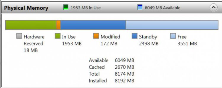

Also use Ram Map from
Windows Sysinternals: Documentation, downloads and additional resources
It gives a color coded bar graph of memory usage similar to that in Windows Seven. You can see what's happening at a glance.
