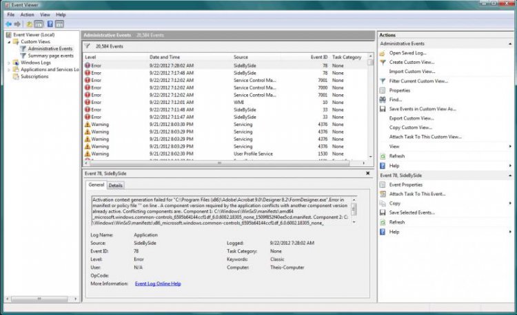

I never knew about the Event Viewer tool. It seems pretty powerful but I am not exactly sure how to read it. I saw several critical events that dealt with the computer loosing power during the transition to Sleep and also an Acrobat reader issue.
Is there a tutorial I can check to see how to interpret the Event Viewer details.

Just make a screen shot and upload to us.
mstheis
This is a screen shot of the Event Viewer with one of the Critical events shown. If this is not what you need, let me know what you want to see and I will get it.

The sleep mode problem was a problem in SP1 and there was a hot fix for it. However, if you have SP2, it shouldn't be an issue.
Don't want to alarm you but the problem you're having happened to me earlier this year. It turned out that the power supply of my display was crapping out and I ended up buying a new display.
Interesting that the log you provided shows a side by side error. That wouldn't cause this problem, in my opinion. It would be the subject of another thread.
