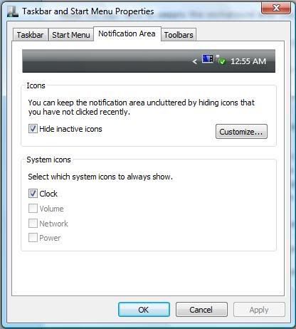

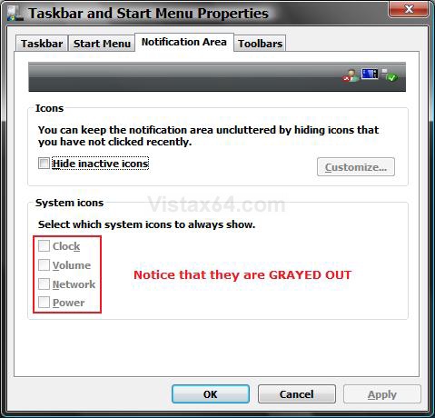

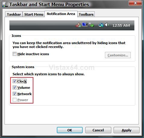

1. Right click on the Taskbar and click on Properties.​
2. Click on the Notification Area tab. (See left screenshot below step 3)​
3. Check (on) or uncheck (off) the options you want or do not want to show on the Taskbar Notification Area.​

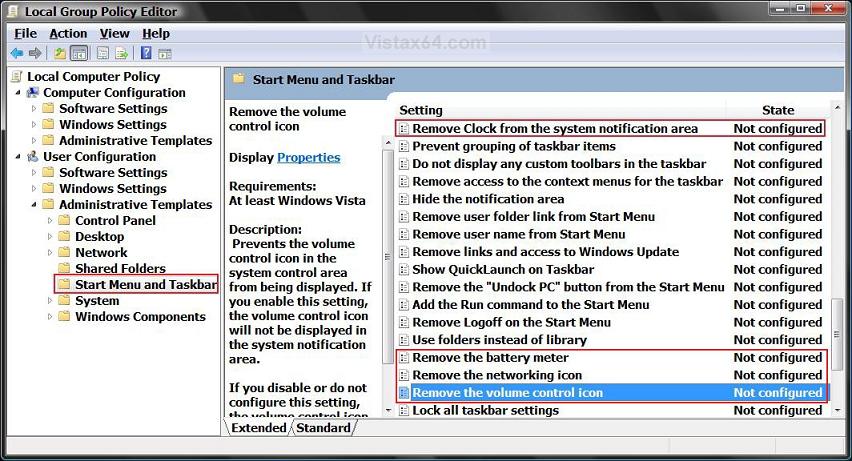

2. In the left pane, click on User Configuration, Administrative Templates, and Start Menu and Taskbar. (See screenshot below)​
3. For the Clock Icon - In the right pane, right click on Remove Clock from the system notification area and click on Properties.​
(See screenshot above)​
A) To Disable the Clock Icon - Dot Enabled and click on OK. (See screenshot below step 7)​
B) To Enable the Clock Icon - Dot Disabled or Not Configured and click on OK.​
4. For the Volume Icon - In the right pane, right click on Remove the volume control icon and click on Properties. (See screenshot above)​
A) To Disable the Volume Icon - Dot Enabled and click on OK. (See screenshot below step 7)​
B) To Enable the Volume Icon - Dot Disabled or Not Configured and click on OK.​

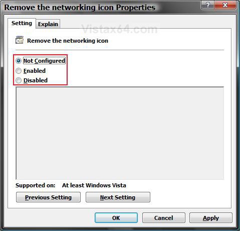

5. For the Network Icon - In the right pane, right click on Remove the networking icon and click on Properties. (See screenshot above)​
NOTE: To make sure that this icon works properly you should also have the Services Network Connections, Network List Service, Network Location Awareness, and Network Store Interface Service set to Started and Automatic. For how, see: How to Disable or Enable Vista Services with an Advice Guide
A) To Disable the Network Icon - Dot Enabled and click on OK. (See screenshot below step 7)​
B) To Enable the Netwok Icon - Dot Disabled or Not Configured and click on OK.​
6. For the Power (battery) Icon - In the right pane, right click on Remove the battery meter and click on Properties. (See screenshot above)​
NOTE: This will remain grayed out unless your computer is a laptop or has a UPS battery backup connected to it. To create a Power Options shortcut, see: How to Create a Power Options Shortcut in Vista
A) To Disable the Power Icon - Dot Enabled and click on OK. (See screenshot below step 7)​
B) To Enable the Power Icon - Dot Disabled or Not Configured and click on OK.​
7. Close the Local Group Policy Editor.​

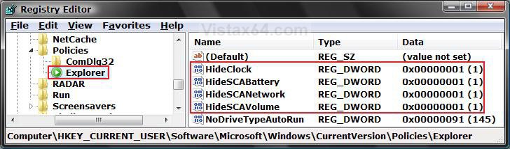

METHOD FOUR
Manually in Registry Editor
NOTE: This method will enable or disable a System icon.
1. Open the Start Menu.​
3. If pompted by UAC, click on Continue.​
NOTE: If Explorer is not there, then right click on Policies in the left pane and click on New and Key. Type Explorer and press Enter.​

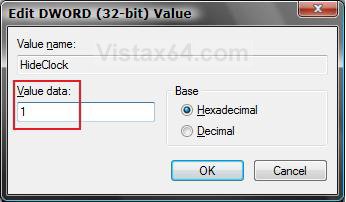

5. To Disable the System Icons - In the right pane of Explorer, right click on a empty area and click on New and DWORD (32-bit) Value.​
A) To Disable the Clock Icon - Type HideClock and press Enter.​
B) To Disable the Volume Icon - Type HideSCAVolume and press Enter.​
C) To Disable the Network Icon - Type HideSCANetwork and press Enter.​
D) To Disable the Power (battery) Icon - Type HideSCABattery and press Enter.​
E) In the right pane, right click on the one you just typed to disable and click on Modify.​
F) Type 1 and click on OK. (See screenshot below)​
NOTE: Repeat for each step you did in 5A to D.​

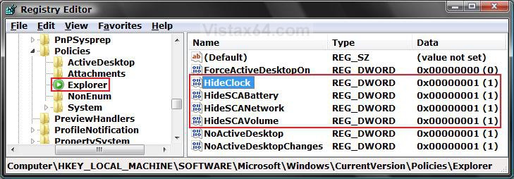

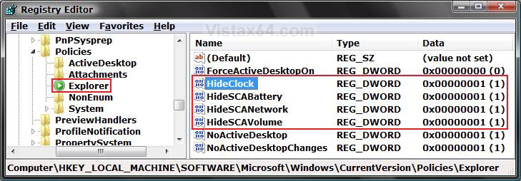

6. To Enable the System Icons - (See screenshot below step 5E)​
A) To Enable the Clock Icon - Right click on HideClock and click on Delete.​
B) To Enable the Volume Icon - Right click on HideSCAVolume and click on Delete.​
C) To Enable the Network Icon - Right click on HideSCANetwork and click on Delete.​
D) To Enable the Power (battery) Icon - Right click on HideSCABattery and click on Delete.​
E) Click on Yes to confirm the delete.​
F) In regedit, go to: (See screenshot below)​
HKEY_LOCAL_MACHINE\SOFTWARE\Microsoft\Windows\CurrentVersion\Policies\Explorer
G) In the right pane, repeat steps 6A to 6E if they are here to.​

The Power icon option will usually stay grayed out unless you are running a laptop on battery power, or have a desktop plugged into a backup battery UPS.
Is this this the case?
