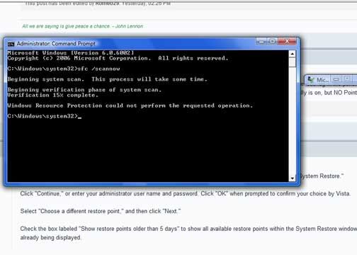

Romeo...heres the result of the scannow cmd....

Just to let everyone know...Im working on the scannow and trying to get it to finish...it gets to about 65-75% most of the time and stops...
The suggestion to use this article...How to use the System File Checker tool to troubleshoot missing or corrupted system files on Windows Vista or on Windows 7...
hasnt helped much...I see what it wants me to do but i just cant seem to get it all to go. (its a lil above my knowledge) I get nothing from the cmds it want me to put in.
And as far as the Icon Rebuild...Im not sure thats the main problem at this point, with all the Lag and the scannow not able to finish I want to figure this stuff out first before i do that...UNLESS someone thinks this may be the cause of all of it...

I have run my Malewarebytes several times and made sure it was updated first...also several Virus Scans with Avast to no avail... Im in process of a scannow and hopefully this time it will give me a log file with something in it...the first timw I was able to get it to even FINISH...the log File was empty...
*Update*
scannow finished and gave a sfcdetails.txt file which I have attached...

Run SFC 3 times. It does not fix it all at once.
If that does not work, try a repair install, but you need the install DVD. You can borrow or beg for one if you do not have it
#5
That is an incredibly abnormal SFC report. The error message you first received means that there are serious WinSxS corruptions that can only be fixed by looking at the CBS.log. Yet suddenly your computer has fixed that error by itself, and nothing shows up in SFC log. I am in half a mind to take your entire CBS.log just to confirm that no CSI errors have ever occurred. This is almost harder for me to fix than three corruptions!

Ran a second time and heres the sfcdetails.txt form that one...gonna run a third and do the same...
And heres the third....
They all look the same to me...I'm not sure why the timestamps are the same on all of them....
