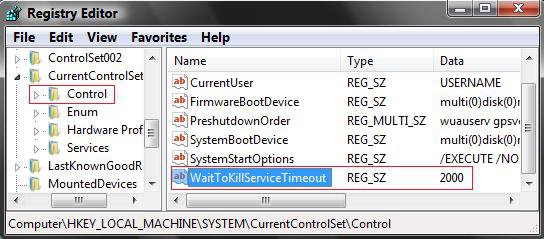

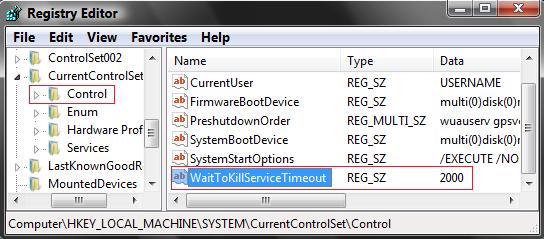

4. In regedit, navigate to the location below. (See screenshot below)​
HKEY_LOCAL_MACHINE\SYSTEM\CurrentControlSet\Control

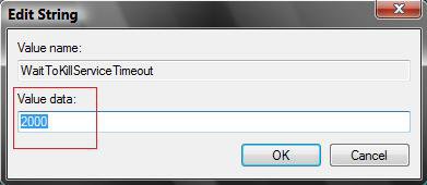

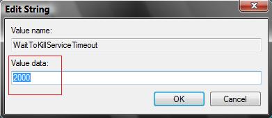

5. In right pane, right click on WaitToKillServiceTimeout and click Modify.​
6. Type in a number between 2000-20000 (2-20 seconds) and click OK. (See screenshot below)​
NOTE: The default time is 20000. I use 2000 and have not had any problems. Your experience may vary.
