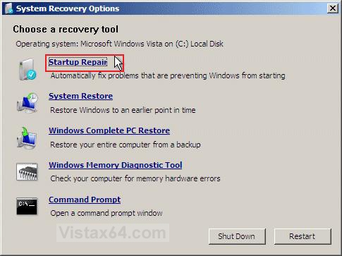

1. Boot into the System Recovery Optionsscreen.​
2. Click on the Startup Repair option. (See screenshot below)​

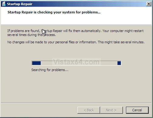

3. The Startup Repair tool will attempt to fix your computer and get it booting up again. (See screeshot below)​
NOTE: Startup Repair might prompt you to make choices as it tries to fix the problem, and if necessary, it might restart your computer as it makes repairs. If repairs are not successful, you'll see a summary of the problem and links to contact information for support. Your computer manufacturer might include additional assistance information.
Sometimes it may take running Startup Repair up to 3 times with a restart after each time to fully repair startup issues.
