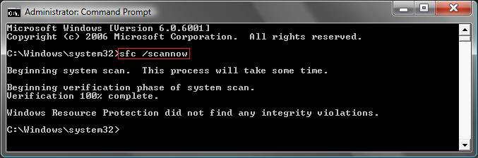

A) sfc /scannow - Scans the integrity of all protected system files and repairs the system files if needed. (See screenshot below)​
NOTE: Restores Vista's original setup of system files. (EX: Fonts, wallpapers, System32 files, etc.)

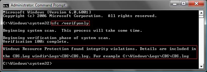

B) sfc /verifyonly - Scans and only verifies the integrity of all proteced system files only. (See screenshot below)​
NOTE: If it finds anything like in the screenshot below boxed in red at the bottom, you should run step A to see if it can fix it. See how to read the CBS log above for details on the SFC scan results.​

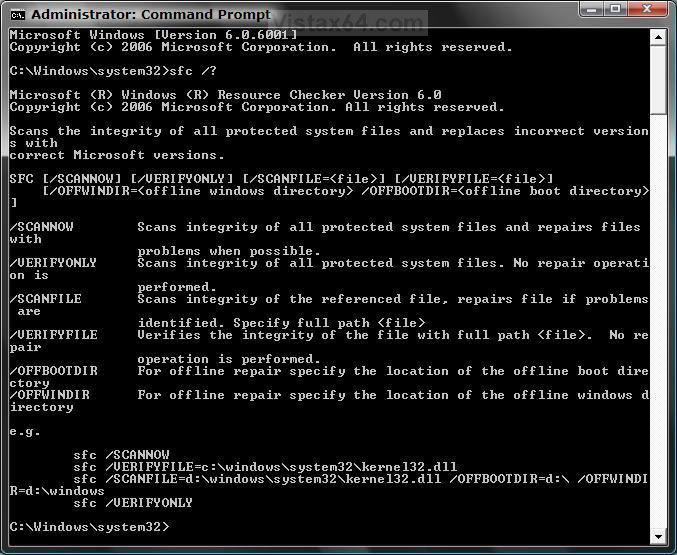

E) sfc /? - For a list of all sfc command codes with description. (see screenshot below)​
