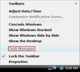

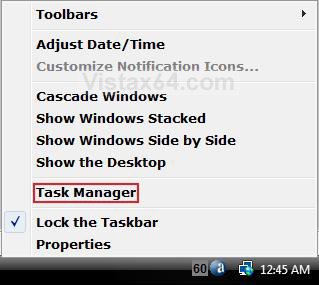

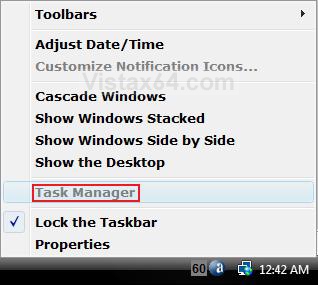

If you find that the Task Manager option is grayed out (disabled) when you right click on the taskbar, then you may want to enable it again. You may also want to disable the Task Manager to prevent other user accounts from using it.
This will also add or remove Task Manager from the Windows Security screen when you press Ctrl+Alt+Delete.

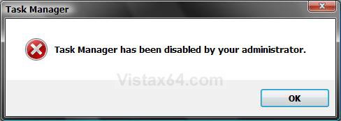

When the Task Manager is disabled, the CTRL+SHIFT+ESC does not work, Task Manager will not appear in CTRL+ALT+DELETE, and Task Manager is grayed out when you right click on the Task Bar.
EXAMPLE: ERROR MESSAGE
NOTE:
You get this when you try to run taskmgr.exe .

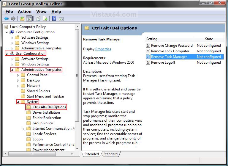

2. In the left pane, click on User Configuration, Administrative Templates, System, and Ctrl+Alt+Del Options. (See screenshot below)​
3. In the right pane, right click on Remove Task Manager and click on Properties. (See screenshot above)​

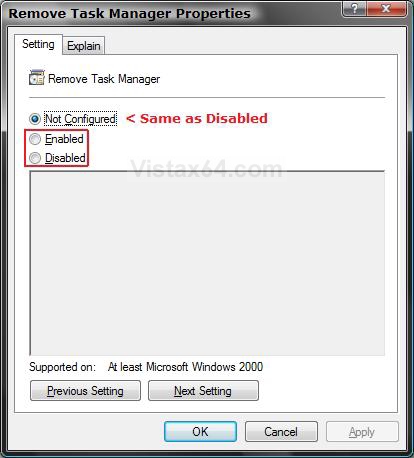

4. To Enable Task Manager
A) Dot Disabled or Not Configured and click on OK. (See screenshot below step 5A)​
B) Go to step 6.​
5. To Disable Task Manager
A) Dot Enabled and click on OK.​

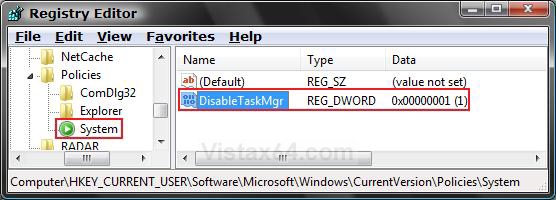

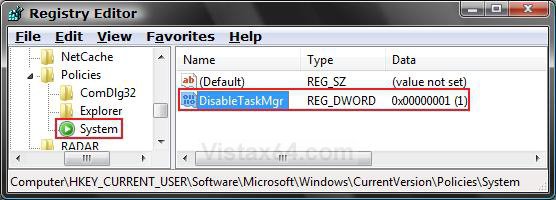

4. In regedit, navigate to the location below. (See screenshot below step 5A)​
NOTE: If you do not have System, then right click on Polices and click on New and Key. Type System and press Enter.
HKEY_CURRENT_USER\Software\Microsoft\Windows\CurrentVersion\Policies\System

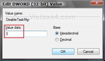

A) In the right pane, right click on a empty area and click on New and DWORD (32-bit) Value and type DisableTaskMgr and press Enter. (See screenshot below)​
B) Right click on DisableTaskMgr and click on Modify. (See screenshot above)​
C) Type 1 and click on OK. (See screenshot below)​
6. To Enable Task Manager
A) In the right pane, right click on DisableTaskMgr and click on Delete. (See screenshot below step 5A)​
B) Click on Yes to confirm delete.​
