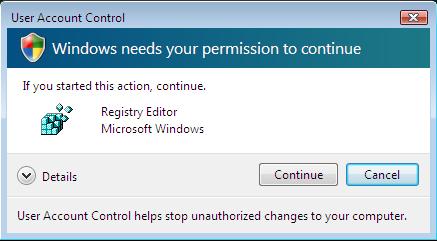

EXAMPLE: UAC Prompt

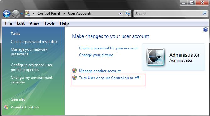

Through the Control Panel
2. Click on the User Account icon.​
3. Click on Turn User Account Control on or off. (See screenshot below)​

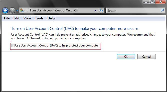

4. To Turn Off UAC
A) Uncheck Use UAC to help protect your computer. (See screenshot below step 5)​
NOTE: When you turn off UAC, the Security Center will give you an alert warning notification in the notification area of the taskbar until you turn UAC back on. To turn this alert off, see: How to Disable or Enable the Security Center Alert Warning Notification in Vista
B) Go to step 6​
5. To Turn On UAC
A) Check Use UAC to help protect your computer. (See screenshot below)​
6. Click on OK.​

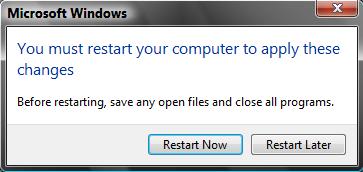

7. Click on Restart Now to apply the changes. (See screenshot below)​
WARNING: This will restart the computer when clicked on. Be sure to save and close anything else running first.​

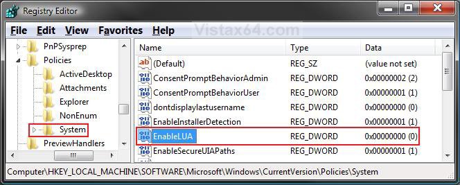

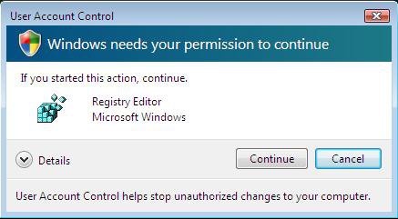

Manually in Registry Editor
1. Open the Start Menu.​
HKEY_LOCAL_MACHINE\SOFTWARE\Microsoft\Windows\CurrentVersion\Policies\System

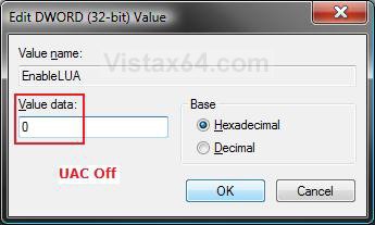

5. To Turn UAC Off
A) In the right pane, right click on EnableLUA and click on Modify. (See screenshot above)​
B) Type 0 (Number Zero) and click on OK. (See screenshot below)​
C) The registry will now look like this. (See screenshot below)​
D) Go to step 7.​

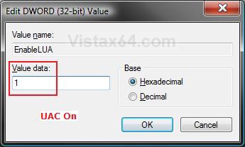

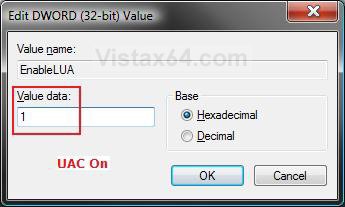

6. To Turn UAC On
B) Type 1 (Number Zero) and click on OK. (See screenshot below)​
C) The registry will now look like this. (See screenshot below step 4)​
