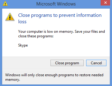

If you receive any type of low memory error message like below, then you need to either add more RAM or increase the size of the page file so that you can run the programs on your computer.

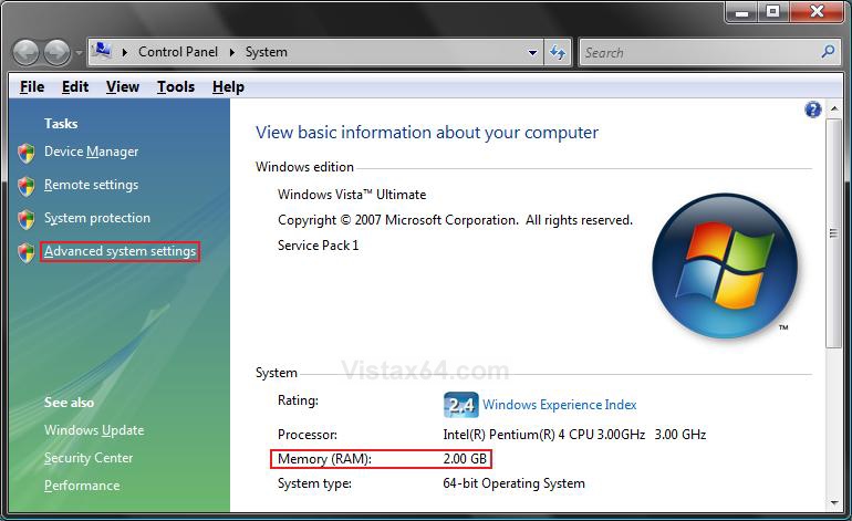

1. Open the Start Menu.​
A) Right click on the Computer button and click on Properties.​
B) Go to step 3.​
OR
2. Open the Control Panel (Classic View - Vista or Icons view - Windows 7).​
A) Click on the System icon.​
3. Click on Advanced system settings. (See screenshot below)​
NOTE: While your here, note how much Memory (RAM) you have installed under the System section.​
4. If prompted by UAC, then click on Continue (Vista) or Yes (Windows 7).​

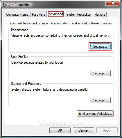

5. In the Advanced tab, click on the Settings button in the Performance section. (See screenshot below)​

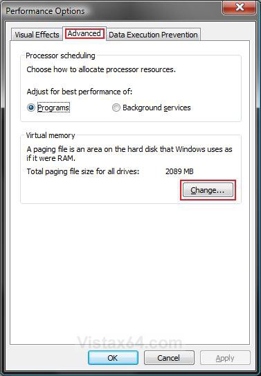

6. Click on the Advanced tab. (See screenshot below)​
7. Under Virtual memory, click on the Change button.​

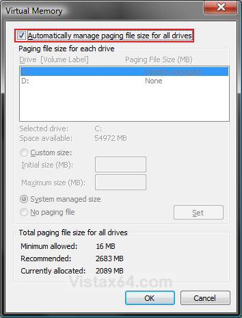

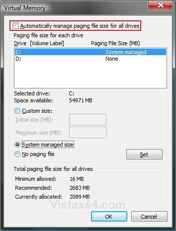

8. To Turn Off Automatic Virtual Memory Management for All Drives
A) Uncheck the Automatically manage paging file size for all drives box. (See screenshot below)​
NOTE: This turns off automatic virtual memory management by Windows so you can manually change the drive and size to what you want instead.​
B) Go to step 10.​

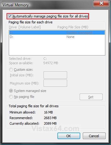

9. To Turn On Automatic Virtual Memory Management for All Drives
A) If one of the listed drives (ex: C: ) is set as System Managed already, then check the Automatically manage paging file size for all drives box. Click on OK and go to step 17. (See screenshot below)​
OR
B) If one of the listed drives is not set as System Managed already, then uncheck the Automatically manage paging file size for all drives box and do step 10 and step 12.​

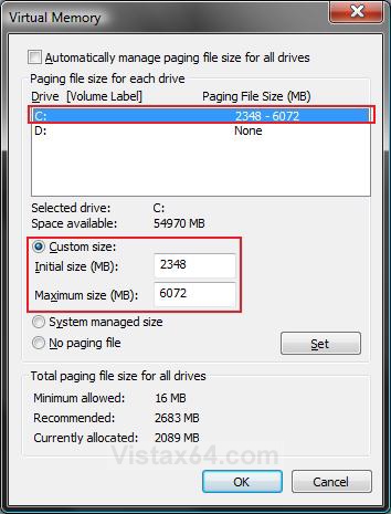

10. To Select a Drive to Add or Change the Paging File
NOTE: By default, Windows uses the same drive letter that it is installed on. This system drive is usually the C: drive.​
WARNING: If you have another internal NTFS drive listed and want to use it instead, then make sure it is as fast or faster than the drive Windows is installed on. Make sure you only use a separate hard drive, not another partition on the same hard drive as Windows is installed on. This will cause a decrease in performance if you do. You cannot move the page file to an external or removable drive.
A) Click on a listed hard drive you want to change or add a paging file to for Windows to use. (See screenshot below step 9A)​

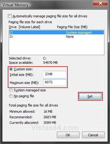

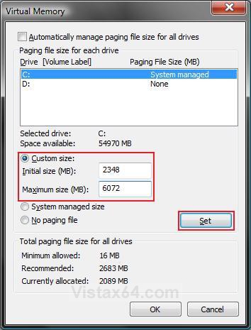

11. To Have a Custom Paging File Size for the Selected Drive
NOTE: You would do this if you do not want to use the automatic system managed size by Windows.​
A) Dot Custom size. (See screenshots below step 15)​
B) Type in a size for the Initial size in MB (1 GB = 1024 MB).​
NOTE: This will be the minimum size.​
C) Type in a size for the Maximum size you want in MB (1 GB = 1024 MB).​
D) Go to step 14.​
12. To Have a System Managed Paging File Size for the Selected Drive
NOTE: This will let Windows automatically manage the size of the paging file for this selected drive as needed.​
A) Dot System managed size. (See screenshots below step 9)​
B) Go to step 14.​
13. To Remove the Paging File from the Selected Drive
WARNING: Make sure that you have at least one drive selected to have a paging file on. Otherwise your computer may slow down dramatically.​
NOTE: You would usually only do this if you have more than one drive that you already added a paging file to from step 11 above.
A) Dot No paging file. (See screenshots below step 15)​
14. Click the Set button. (See left screenshot below)​
NOTE: Repeat steps 10 to 14 if you would like to make more changes to the paging file, or add a paging file to another listed drive.​
15. Click on OK. (See right screenshot below)​

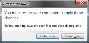

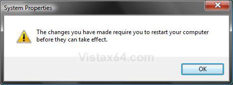

16. If the Paging File Size was Decreased
NOTE: If the paging file was decreased, the computer will need to be restarted before the changes can be applied. You will not see this if you increased the size.​
A) Click OK. (See screenshot below)​
17. Click on OK. (See screenshot below step 7)​
18. Click on OK. (See screenshot below step 5)​
19. If the Paging File Size was Decreased
NOTE: You will not see this if you increased the size.​
A) Click Restart Now. (See screenshot below)​
NOTE: Be sure to save and close anything open first. This will restart the computer immediately.​

I followed this just for the heck of it.
I have Vista Home Basic.
I increased the min and max, I was told I needed to restart. The tut says restart ONLY if decreased.
Hi MicroMan,
Interesting. I just played with mine some more, and I could only get the restart if I decreased the min/max. I even tried multiple increases in a row, but still had no restart notice.
What were your numbers originally, and what did you increase them to? I'll try that and see if I can trigger a restart notice. Include any other details you think may apply to.
Thank you,
it was somewhere around 3300 to start, sorry I didn't keep track.
I uped it to 4500-7000, then changed it again to 5000-7000. That's where it's at after reboot.
I'm not sure what may have triggered the restart for you since you only increased the sizes. I tried with what you stated and still did not get a restart notice. Must be a fluke. If you increase it more again, does it give you a restart notice?
