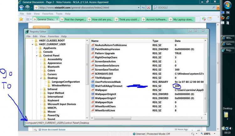

I created the reg key that you mentioned but the machine hung shortly after when running the fujitsu updater. I guess i need to create the other keys to go with it, eg KillServices
