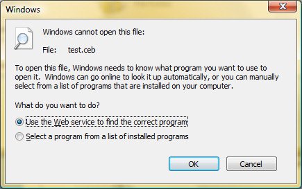

I ran a quick test, and created a file "test.ceb" on my computer. An when I double-clicked it, I got this:
It therefore stands to reason that "Windows Shell Common Dll" is used when opening unknown file types. If this is the behaviour that you are getting, then there are no problems.
