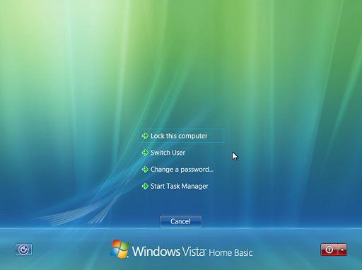

This will show you how to add or remove Log Off from the the Windows Security screen when you press CTRL+ALT+DEL for all user accounts on the computer.
This will also add or remove Log off from the Shut Down Windows screen when you press ALT+F4 from the Desktop. For more about this, see: How to Shutdown, Restart, Switch User, Log Off, Sleep, or Lock Vista from the Keyboard
EXAMPLE: Default (Added) Log Off and Removed Log Off

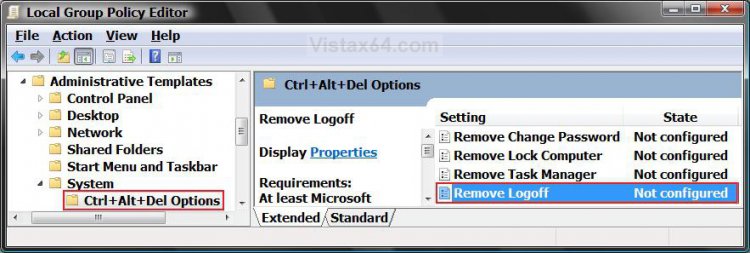

2. In the left pane, click on User Configuration, Administrative Templates, System, Ctrl+Alt+Del Options. (See screenshot below)​
3. In the right pane, right click on Remove Logoff and click on Properties. (See screenshot above)​

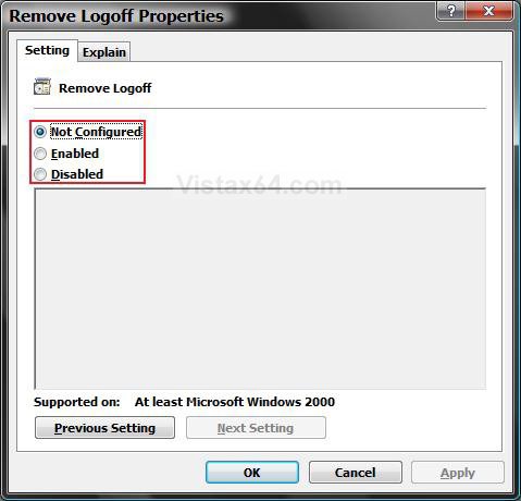

4. To Add Log Off
A) Dot Disabled or Not Configured and click on OK. (See screenshot below step 5A)​
B) Go to step 6.​
5. To Remove Log Off
A) Dot Enabled and click on OK.​

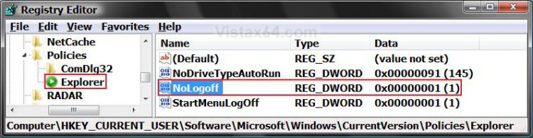

1. Open the Start Menu.​

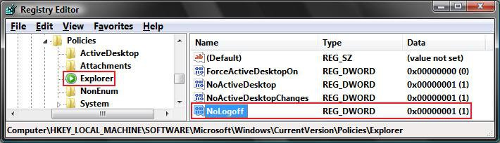

4. In regedit, go to: (See screenshot below step 5C)​
NOTE: If you do not have Explorer, then right click on Polices and click on New and Key, then type Explorer and press Enter.
5. To Remove Log Off from the Ctrl+Alt+Del Screen
A) In the right pane, right click on a empty area and click on New and DWORD (32-bit) Value. (See screenshot below)​
B) Type NoLogoff and press Enter.​

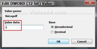

C) Right click on NoLogoff and click on Modify.​
6. To Add Log Off to the Ctrl+Alt+Del Screen
A) In the right pane, right click on NoLogOff and click on Delete. (See screenshot below step 5C)​
HKEY_LOCAL_MACHINE\SOFTWARE\Microsoft\Windows\CurrentVersion\Policies\Explorer
D) In the right pane, repeat steps 6A and 6B if NoLogOff is there to.​
