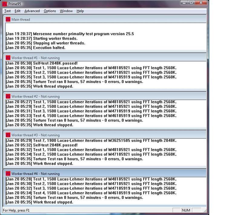

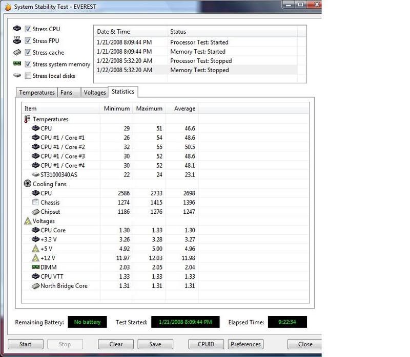

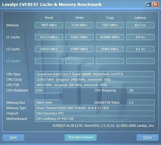

Oh, if it helps at all, here's what I ended up with on my own box:
General Settings and Info:
Everest Stress Test - voltage and temps page:
Prime 95 Stress Test, cos it's rougher on your comp than Everest:
