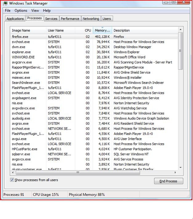

I have 2GB of memory.
Again, right now I have Firefox open, that's it and 1.57GB on memory is used up. Some of the high users:
AVG has 9 different processes running; total: 87.5K memory used (0% CPU used)
Firefox: 153K (approx 15% CPU)
svchost: 98K (0% CPU)
All the rest are under 15K each.
Should those top 3 be using so much memory??
CPU right now is very low - around 15%.
Also, why do the processes that use so much memory use so little CPU power?
So it looks like CPU is not my problem, but memory...

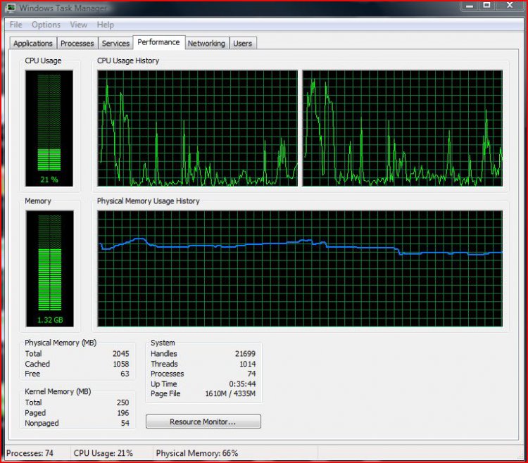

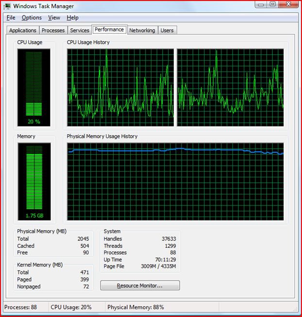

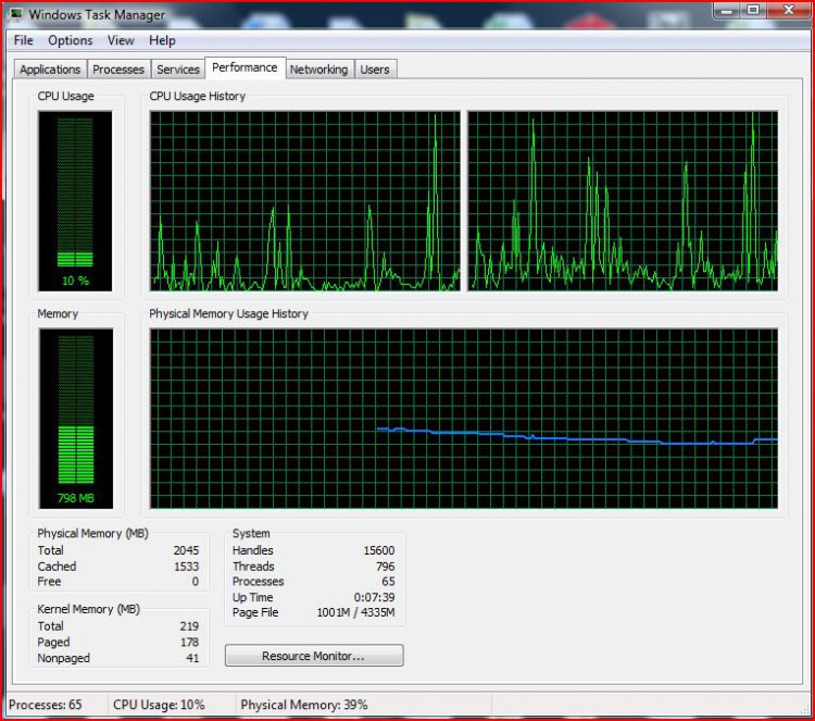

Post a screenshot of Task Manager - Performance tab, when the problem occurs. The numbers quoted don't make sense.
Edit: That is the numbers in the first post make no sense.
Note that there is no relationship between CPU usage and Memory usage. They are totally different things.

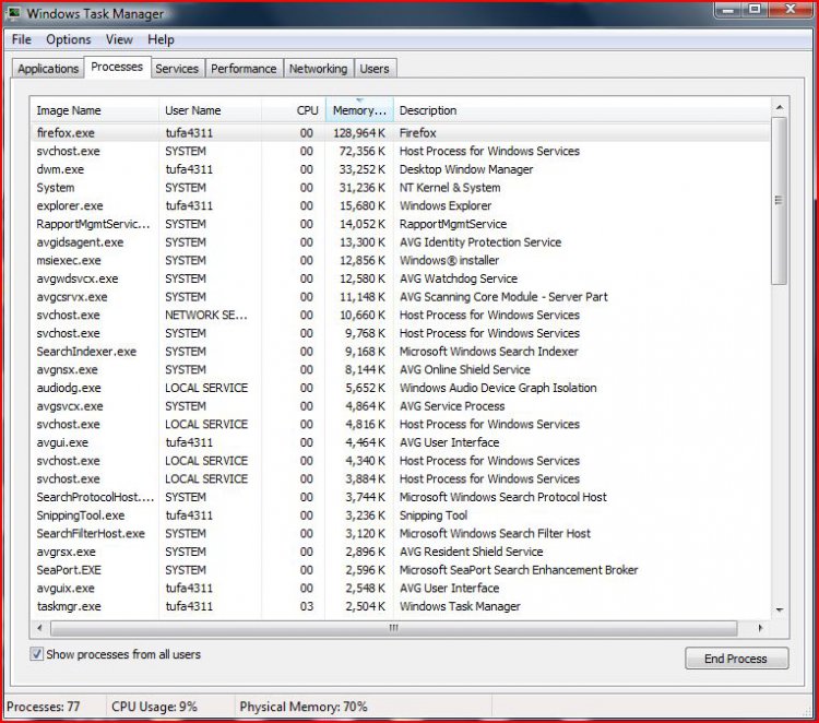

Why do you think this is a lot of memory?
In fact, look carefully again at what task manager shows, it's probably more like 153,000 KB.
153,000 KB = 149.4 MB = 0.15 GB, so about 7.5% of 2.0 GB.
Don't run two anti virus programs at the same time (AVG, Norton)
Try restarting Firefox
What version of Firefox are you running mine is using 233,748K and 6.6% average cpu

Your last screenshots looked normal for Firefox.

My laptop circa 2007 running Vista, Norton Internet Security (2014), and Firefox with a few tabs open shows about 1.2 GB memory used. My laptop is somewhat pokey with 2GB, but better than new when it had only 1GB!
