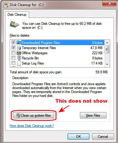

I wanted to do a disk clean to remove all but the last restore point. It does does not give an option for "More Options" which I am used to on Win XP and Win 7.

See the following for how to clean all but the last restore point in Vista: How to Remove or Delete all System Restore Points Except the Most Recent in Windows 7 and Vista?.

The option you require is still available in http://www.vistax64.com/tutorials/76073-disk-cleanup.html, however you need to select the option Files from all users on this computer in order to be able to do so.

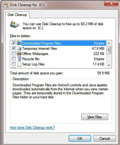

When I try to elimate all but the last restore point this is what I should see:
This is what I actually see:
I have used Ccleaner for other purposes and I know it is a very good utility. In this case I had to use it to delete the restore points that were not needed. I had not known Ccleaner could do that so thanks for the heads-up.
