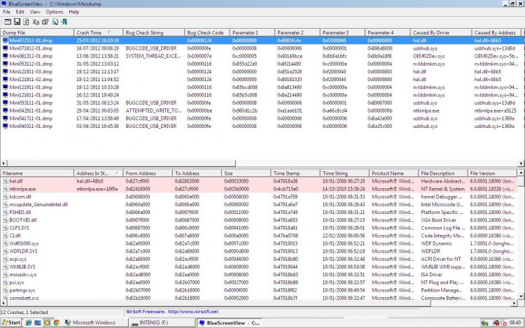

Basically, my screen keeps flickering and what not, not a typical BSOD. Although when I logged in this morning, it said it had recovered from a BSOD...
I loaded up BlueScreenView and found this errors, please find attached picture,
