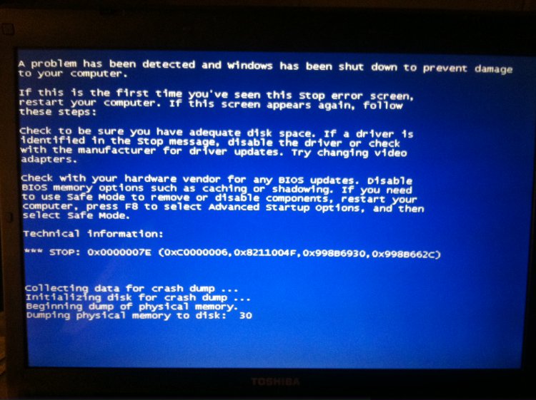

The blue screen says
STOP: 0x0000007E (0xC0000006, 0x820FC04F, 0x9876B930, 0x9876B62C)

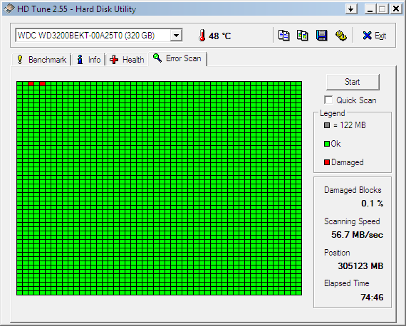

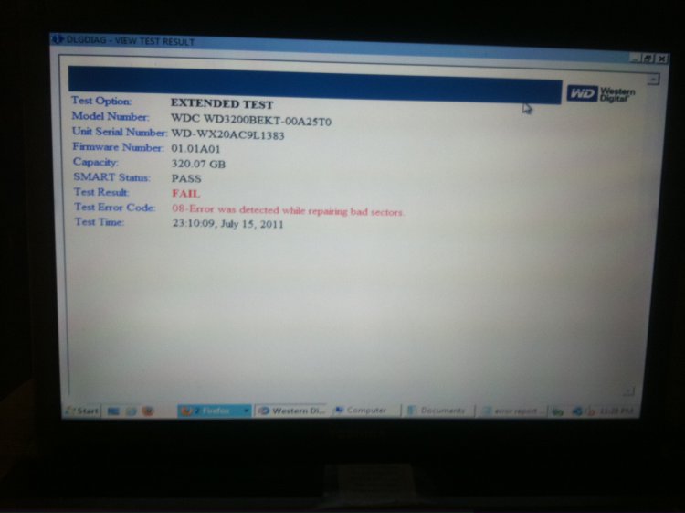

Ok so i have run two different HD Diagnostic on the Harddrive both
come back saying that the hard drive does have bad sectors to it.
I used HD Tune (screenshot attached) and the Western Digital Data Life
Guard Diagnostic aka DLGDIAG (picture of error attached). The DLGDIAG
said there were bad sectors and that I could repair them. I tried to
repair them and then received the error message within DLGDIAG stating
that an error occurred while trying to repair the sectors. I then restarted it and got the BSOD.
Also attached is the BSOD. This is now officially worst than taxes.
