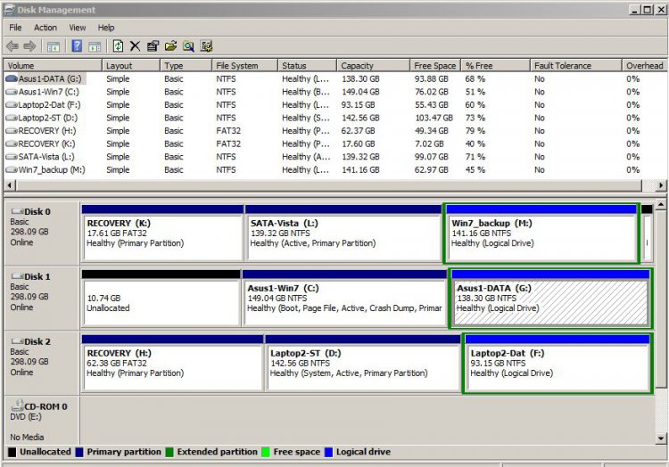

Could you post a screenshot of your Disk Management to see how your drives are layed out? This can help to see what you may be looking at to do this.

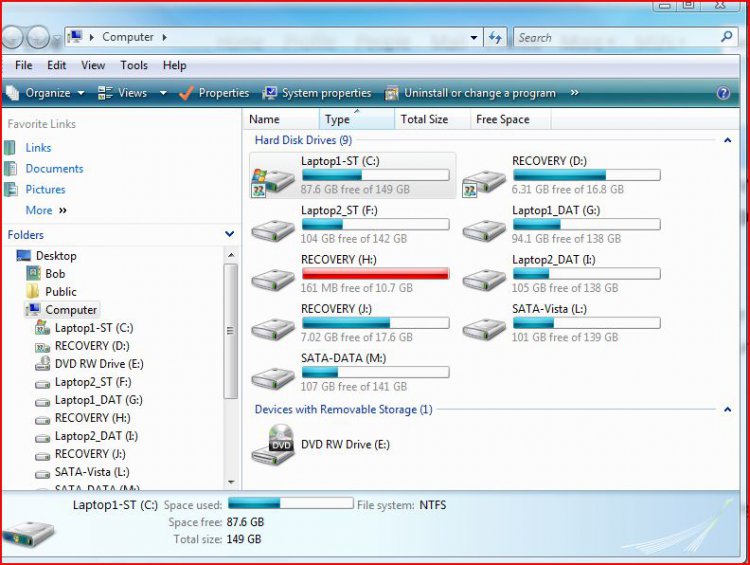

I clicked attachment--did it show?
Asus G50. I have been on the phone with their tech supporto for about three hours last night and tonight. There is no repair. They only offer "scorched earth" recovery, which I have on a CD. I certainly don't need it in three partition. Tech support said it was possible to copy/paste data into Vista, knowing I would lose some links, but compared to the entire weekends I have spend on this same issue in the past, I figure why not?

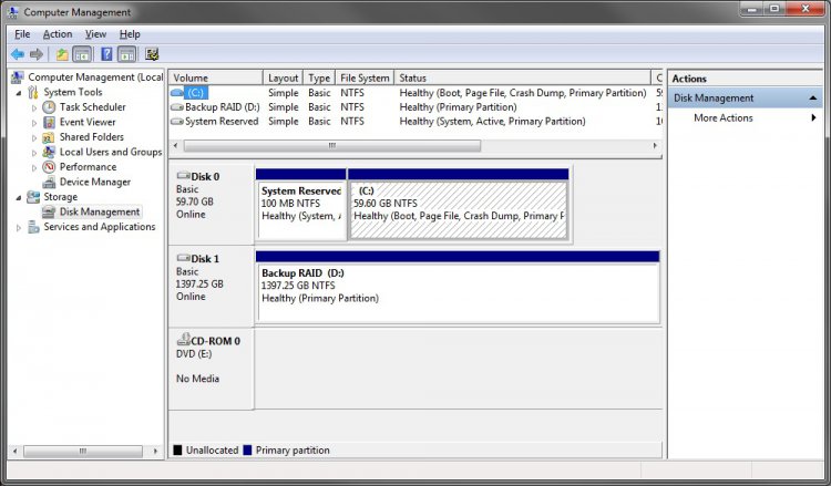

That would be the Computer window. It needs to be Disk Management (diskmgmt.msc) like the one below instead to see how the disks are layed out.
Sorry

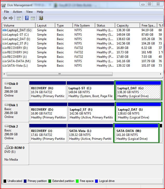

Using your PartitionMagic, you can move around the free space on a single disk to any of the partitions on that same disk. However, to make each disk one partition (drive) again, it will require deleting all 3 partitions on a disk to merge them as one and reinstalling anything that was on them again. That's going to be a lot of backing up of anything that you do not want to lose to accomplish this. :(

I have not yet taken the plunge, but one question: both 'diskmgmt.msc' and Partition Manager agree that:
disk 0 is the external ESATA drive
disk 1 is the second drive listed in boot manager [when I boot up]
disk 2 is the first drive listed. [C:\]
It would seem that disk 0 should be the first drive, but it's disk 2, the second internal laptop drive. Is this odd? Or since it works, just ignore it?

Could you post a screenshot of your Disk Management? This way I can be sure of you drive layout first. :)
It lists your DISK 1 as the boot drive. Normally DISK 0 is, but it's not uncommon for this to happen when multibooting operating systems. I'm not sure how your external drive became DISK 0 though.
What makes it more confusing, is that no matter what OS you boot into, it's partition or drive will show as the C: drive.
When you do this, be sure to not delete the C: drive listed on DISK 1 in the image above since this is your boot drive.
