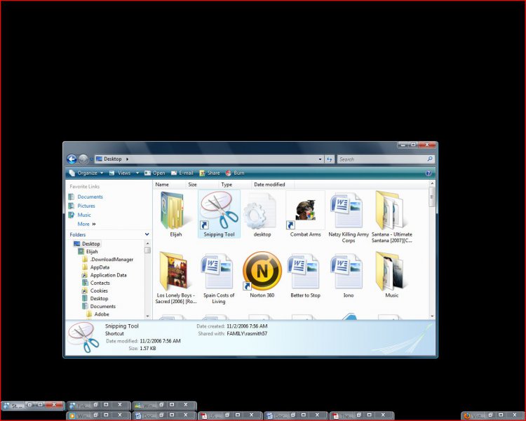

Several months ago, I was attempting to install software that I didn't think to consider was not compatible with Vista. It was made for Windows XP, and I was deleting files on my C: Drive to make room. I accidentally deleted a file that took my desktop with it. Now, when I log on, to any user on the computer, there is a black screen with the "My Computer" window up. I've included a picture to show. Minimized windows are irrelevant. I'm just multi-tasking at the moment. Anybody know how to fix this?

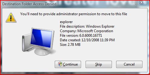

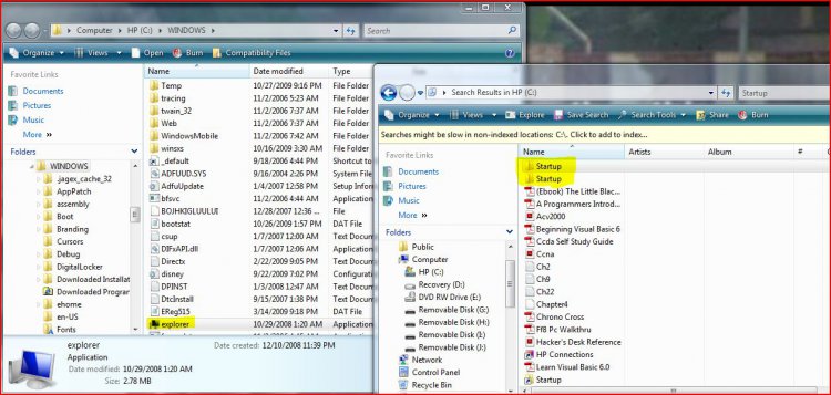

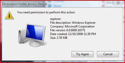

Okay. Everytime I try to add explorer.exe to my startup folder, it gives me "You must give permission" So I give it permission, then it tells me it cannot move because I don't have permission. I'll add screen shots in order as they appear to me. Ignore the missing icons, they're hidden by my doing. I drag "explorer" to the top startup menu (first photo. You'll notice there are two. One is a shortcut from somewhere.) in the second photo, I click on "continue." It give me a window with "User Account Control" which I cannot take a screen shot during. It locks out access to everything else. The two options are "Continue" and "Cancel." I click on "Continue" and it brings me the third photo. Every time I click "Try Again" it gives me the same thing. The image momentarily minimizes, then restores, and gives me the same "Try Again" or "Cancel" Options. I cannot drag explorer to the StartUp menu, and when I try to access the Startup menu from the Control Pannel, it only gives me the options to Change or Remove already existing programs.

Jah,
You only want to Copy it and not Move it.
