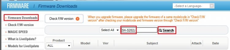

When there, click on the Firmware Downloads link and type in SH-S202J, then click on Search.

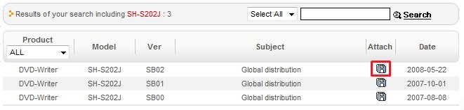

Next, click on the disk file icon.

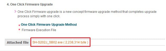

Finally, click on the SH-S202J_SB02.exe file link at the bottom of the page, and save it to your desktop and run it. This will update your DVD drive's firmware.
