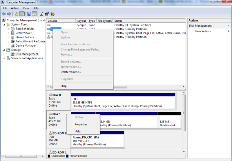

Have a look in Disk Management whether the disk has a drive letter assigned. If not, right click on it and assign (any) one.

Ok, right click on the left part where it says Disk0, Disk1, etc. and try to "Initialize", then the letter.

Unfortunately, the right click menus obscure a lot of info. Could you post another picture without the right click menus. And also with the disk sizes in the upper part.

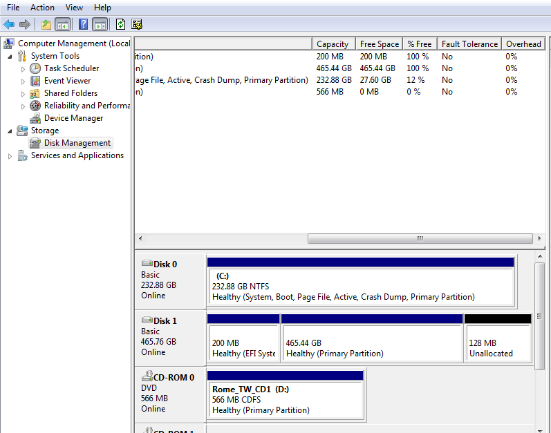

The 'Initialize' option was not available when I clicked. I took a screenshot of what I'm getting, hopefully it helps:

OK, since there is no data on these volumes, I suggest to delete them (this is the only option anyhow) - both the 200MB and the 465GB. Then you may be able to define a new partition from all that free space.
If that will not work, we may have to use Partition Wizard Home Edition.

I was not able to delete the 200 MB partition but was able to delete the 465 GB partition. After that I was able to set up its own drive and is currently reformatting, though that process is taking ages.
Unless something goes horribly wrong I think the problem has been fixed. Thanks for the help! :D

Hmm, you should have done a quick format. But now you are hooked for a while. When you are done, download the Partition Wizard (see link above) to deal with the 200MB partition.

How did it work. Did you try the Partition Wizard to deal with the 200MB partition. It is funny that this drive (you said external drive) has this 200MB partition. Was that originally an internal drive. These small partitions are usually allocated for the MBR and for Bitlocker.
