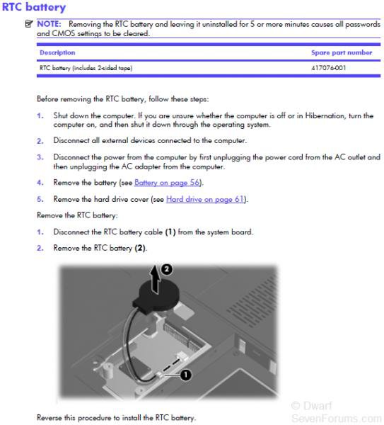

Thanks. I didn't want to assume that the computer listed in your specs was the same as your mothers.
See if disconnecting and then reconnecting the RTC battery helps. You will need to leave it disconnected for at least 5 minutes. This should return your BIOS to its default settings.
Taken from http://h10032.www1.hp.com/ctg/Manual/c01295820.pdf

did that and when first turned on it beeped. then screen with press F1 to continue. so pressed F1, then repair system automatically came on...ran that again and here we go....
