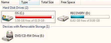

My C: drive is in the "red" and I was told that I need to format it and reinstall Windows Vista. I can't seem to find the Vista Installation Disc. I don't remembering getting one when I purchased the laptop; I have a Dell Insprion 1520.
How do I get this disc?
Also, do I need to format just the c: drive or the d: drive also?

If the OS came preinstalled, you can get one at cost. In lieu of that most computers have a recovery partition that will restore to factory specs. Usually an f key at boot.
You can find out how from your manual or online.
Factory specs is just like a new install.
Your computer does have a Restore partition.
Boot your computer and when the Dell Logo appears press and hold down the Ctrl+F11 key and it should come up with a different screen. There you can choose to restore your computer to original factory settings.
***CAUTION***
Restoring you computer will delete everything you have added when you started using the computer. It is advisable to make a backup of your documents, files, folders, pictures, songs etc. on an external drive.
Once the computer has been restored, it will be exactly the same way you got it from Dell the first time. You can uninstall program which you don't use and you might have to install program which did not came pre-installed with the computer and you want it there.
Make sure that you have all program product codes backed up also. If you would like help with backup, make sure you ask us before you reinstall!
