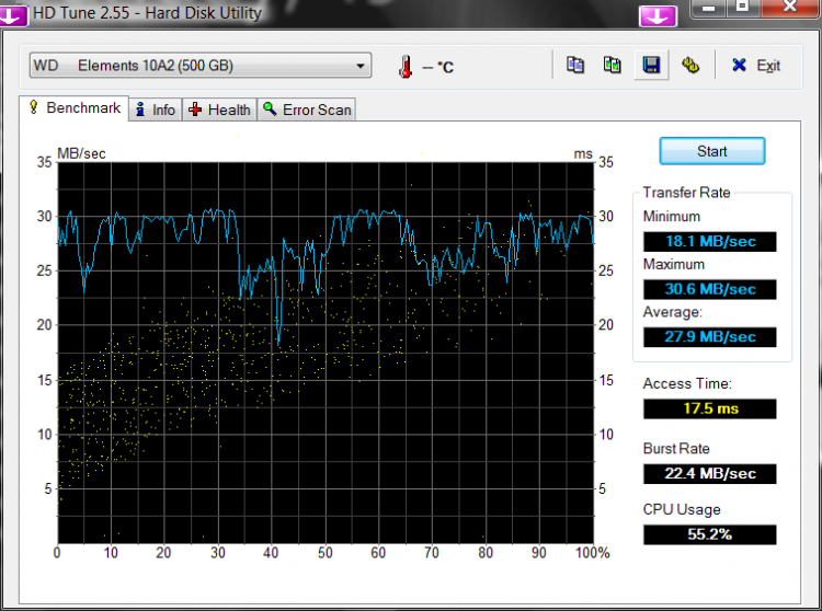

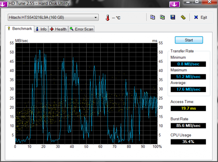

i have two HDD one is 160GB (O/S drive) the other 500GB (spare) i was thinking of swapping out the 160GB currently my os drive for the 500GB for extra storage however would like to know if the performance would be better or worse than whats currently installed
as i would like the extra storage but not at the cost of performance.
i have included screens for comparisson.

Personally, I would use the WD disk for all my operations because it has the highest Access times and transfer rates. On the other hand, the other disk has limited storage space.
However, in using the WD disk for all operations and the other disk for storing files, the bottleneck is going to be the other disc because its transfer rates are woefully low compared to the WD disk.
If you don't have a huge need for storage, I would partition and use the WD disk for everything and use the other disc for compressed backups, if the space is large enough.
I know someone else is going to have the reverse position so we'll let it fly.

hi thanks for the response.
that was my intention to use the wd for my os drive and partition for storage of media etc. and just keep the smaller hitachi drive as a spare
but wasnt sure how to read/compare the readings of hdtune. access time transfer rate etc is higher better or lower better etc etc
didnt want to go through the whole process to find id swapped to a slower performance.
as at the moment im using the smaller hitachi internally with the larger wd connected externally but storage wise made sense to switch to the larger internal and smaller external if/when needed. but not at the expense/loss of performance of windows o/s for instance
so to clarify is the wd or the hitachi best/fastest performance wise

Are you certain that nothing else of significance was running while doing the tests? The relatively high CPU usage and rather erratic performance of the Hitachi drive tend to indicate that something was. If that was the case the tests mean little to nothing.
The access time will be of the greatest importance in general use and low numbers are better. For the other numbers (except cpu usage) higher is better. The average transfer rate will be the most important here.
I was in error in using the word "highest" in regards to the Access times. :sick: I should have said lowest or fastest consistant with what LMiller7 said.

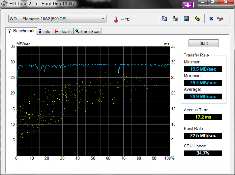

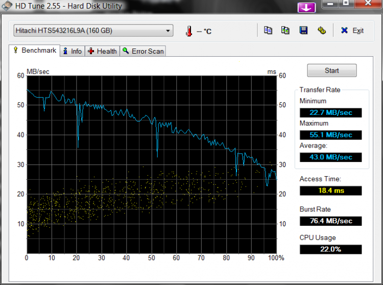

hi thanks guys
i can repeat the test i dont think anything else was running
here are the new tests
really appreciate the help guys

I'm confused, is the WD Elements a usb drive?

hi
yes paton the wd is in an external case connected via usb
as i only have one hdd bay on pc so only way i could do the side by side comparisson

Is that USB 2 or USB 3? To achieve USB 3 speeds both the computer and enclosure interfaces would have to be USB 3. If it is USB 2 that would limit throughput to a maximum of about 35 MB/s and may well be less. In that case you are probably not measuring the drive performance at all but of the USB interface. The performance shown in HD Tune seems too flat, lacking the roll off that the Hitachi drive has. This is unusual for non USB conventional drives.
Do understand that Microsoft does not support installing an OS to an external drive (except Windows 8 Enterprise Edition).

Then your 2 tests are useless, and if your elments is like mine, its deemed a green type drive btw.
Green drives shut down to save power, meaning as an OS drive, it'll stutter while loading if you leave it a bit
Doesn't change my opinion.
How can you advise the WD when the tests are invalid due to the 2 drives in different setups. If you actually believ e that it's valid, then this statement under mines ALL the advice you've ever given pretty much.
Now the next thing is this is all irrelevant as it looks like the acer aspire revo uses a 2.5" drive and the WD is a 3.5" drive, so it won't fit.

The only way to tell for sure is to install the drive and try it.,
The 160Gig is a 5400 rpm drive, and I can't find what speed the WD is.
Try to find a porogram that'll tell you your drive model, then we might be able to help some more.

I'm not sure how he's going to connect the WD drive internally. However, since the tests are done with it connected via the USB bottleneck and it's has a faster access time, I wouldn't think that it would be any slower as an internal drive via any type of connection.
