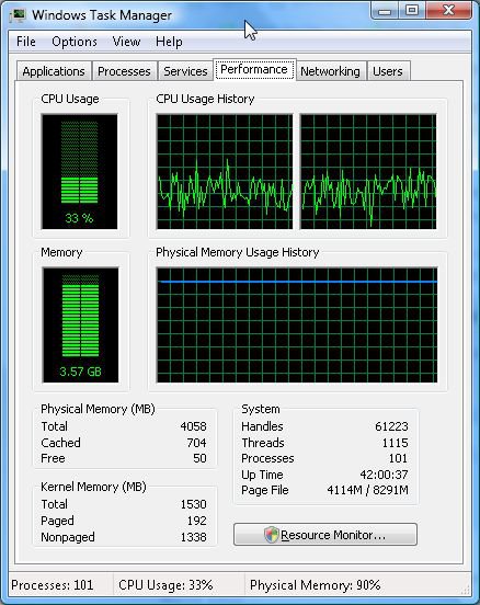

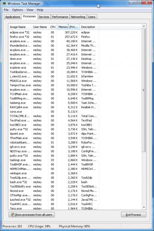

As you can see you were right, and disabling the superfetch service didn't help :-(
I have attached a couple of screenshots of the task manager.
