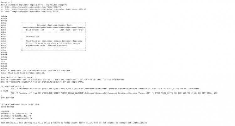

This was the site McAfee gave to download IERegFix.bat:-
http://download.mcafee.com/products/licensed/cust_support_patches/IERegFix.bat
This link did not work under IE 9 as it just came up as a page of code (see attached screen shot) with no method to download I could find, but worked again under IE 8 when I tried it.
I still do not see though why everything that works OK under IE 8 should not under IE 9?
