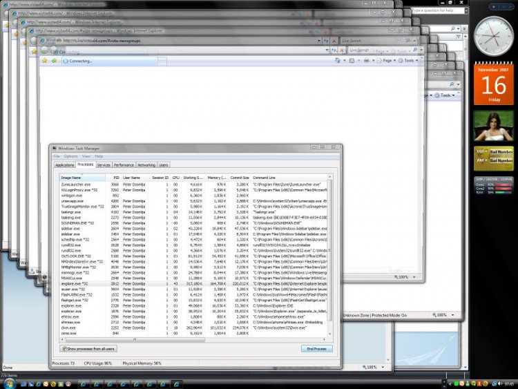

It's happened again. This is what I done:
I opened an email in Outlook 2007 to read a reply to a subscribed thread in the genral NG. I clicked the link to open the thread in IE7 so that I could reply to it myself. That went well, until I decided to close the tab by clicking the "X" on the tab.
The screenshot (which I resized down to 800x600) for space purposes shows what is happening. It took the better part of 2 minutes to be able to get to Task Manager so that I could End Process IEXPLORE.EXE
Maybe there is something else causing this that we haven't seen yet?
Peter,
I am betting that Outlook may have something to do with this. It is a known issue that everytime Outlook updates it will usually automatically set itself as the default email program instead of Windows Mail. This may be throwing things off a bit.
You might try running this again to see if Windows Mail is still the default email program.
http://www.vistax64.com/tutorials/79277-windows-mail-mailto-link-error.html
Since it happened when you clicked the X on the browser tab, make sure that Internet Explorer has all of it's defaults set to it to. See this tutorial for how. Just select "Internet Explorer" and click "Set this program as default".
http://www.vistax64.com/tutorials/83196-default-programs-program-default-associations.html

This time I used the .reg download you provided.
It was 5 days until I got this "cascade" error after checking the tutorial, so we'll see...
