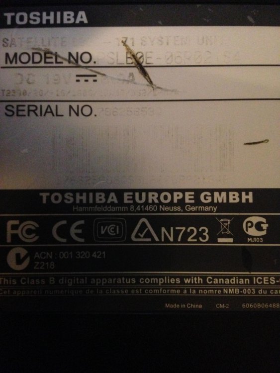

The laptop is a Toshiba Satellite; the model number is a bit faded out but from what I can make out it is: PSL0E- 06R02S4
That number isn't a model number, maybe try looking on the lid for p50, or c60

Did not find any of the letters/numbers anywhere. However this is all that is left (very unclear). Milesahead thanks and I will check out the link now.

The model is right after "Satilite, I think it says D80...
