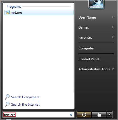

1. Open the Start Menu.​
2. In the white line (Start Search) area, type mrt.exe and press Enter. (See screenshot below)​
NOTE: You can also type mrt.exe in the RUN window. This file is located at C:\Windows\System32\mrt.exe.​

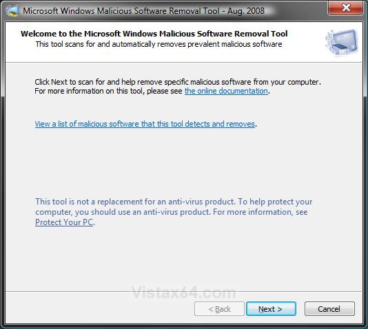

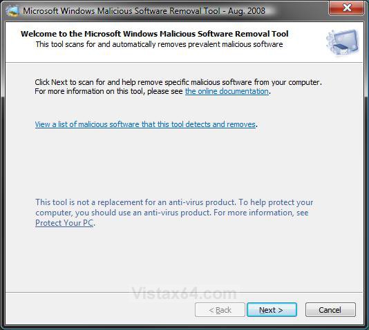

4. Click on the Next button. (See screenshot below)​

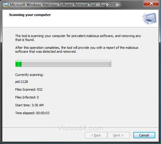

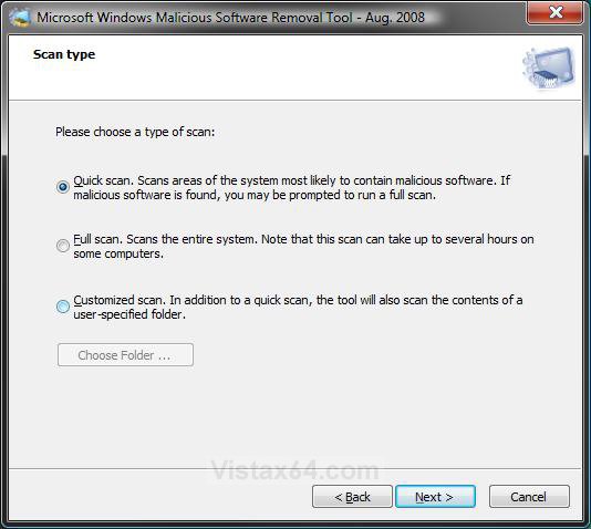

5. Select and dot the type of scan you would like to run and click on Next. (See screenshot below)​

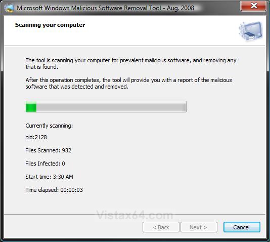

6. It will now start the scan and can take a bit to finish depending on what scan type you selected in step 5. (See screenshot below)​

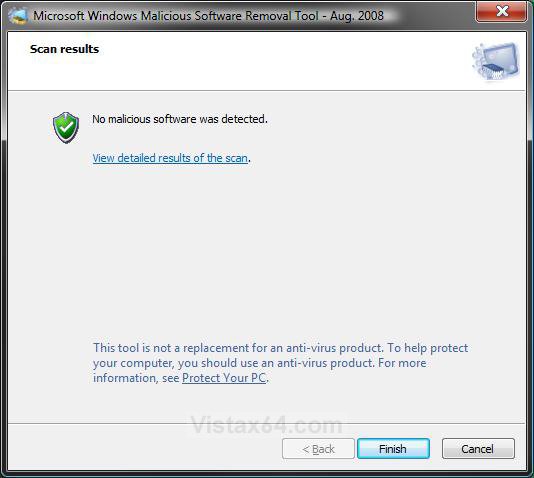

7. When finished, it will report the scan results. (See screenshot below step 8)​
8. Click on the Finish button when you are ready to close the Microsoft Malicious Software Removal Tool window.​
NOTE: To see detailed scan results, click on the View detailed results of the scan link.​

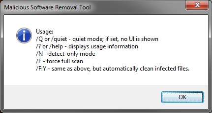

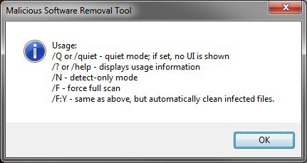

How to Run the "Windows Malicious Software Removal Tool" from the Command Prompt
In a command prompt, type mrt.exe followed by one of the switches below. For example, type mrt.exe /F:Y to run a full scan and automatically clean the infected files.
