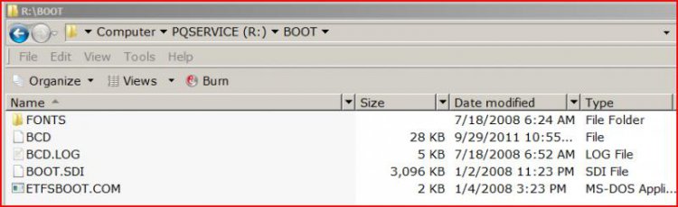

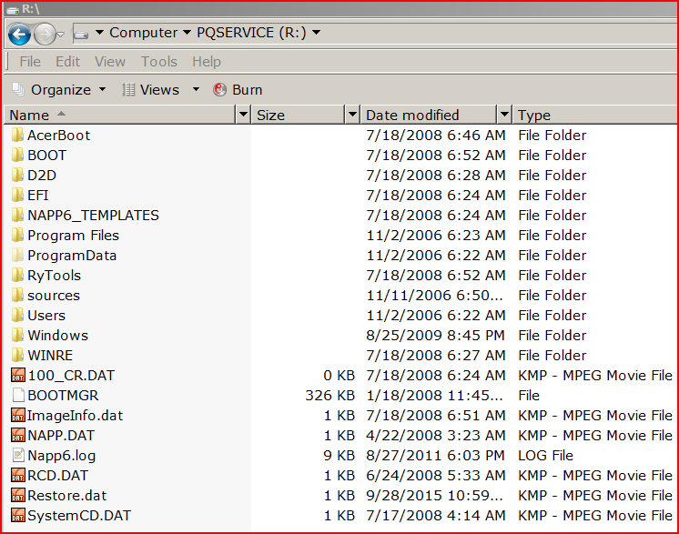

b. Trying to start recovery using the hidden partition... does not work either.
When you use Programs>Gateway>Gateway Recovery Management>Restore tab and command it...it simply proceeds to a shutdown and reboots right back into Vista. Second way-- the manufacturer enter-recovery-during-boot process (Left Alt-F10 while "Gateway" is onsceen, also simply proceeds to boot thru into Vista.
