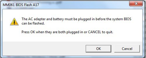

Thanks. As far as I know, the reason I can't update my BIOS because it needs battery detected. So I just still can't update. For this reason, I can't put my laptop to Sleep. Is that true? What should I do to update BIOS (DELL 6400) without battery?

Why can't you update the BIOS? What's the problem? Do you have the proper version? What is or isn't happening when you try? How are you trying to do it (give me the link if you're using online instructions)? The inability to update BIOS is new - you never mentioned that before.
To my knowledge, a battery is not required to update the BIOS in any laptop I've ever worked on. I see nothing to indicate it applies to yours (give me the link if you see something that says that's the case). If you think the battery is causing that problem (because it can't be detected even though inserted), just remove it and simple AC power will do fine (and the inability to detect it will no longer be a factor since it won't be there so of course it won't be detected and that, again, shouldn't interfere with the ability to update the BIOS. Assuming, of course, you can find a BIOS update as I couldn't (not for your current OS) - and if you're using the wrong one (even if it says it's for your computer but you have a different OS than before and it doesn't say the BIOS applies to that OS and using Windows 7 BIOS on your computer if not designed for your computer won't work either - and may even cause some serious problems) that may well be the reason.

Dear Lorien
Thanks for your help. I can't succeed in any things I have tried as what suggested. Because No Battery Detected, the message appears that I still can't update BIOS. One more problem is that I can't put my computer to Sleep. The screen just go black when I try to put it to sleep, but when I touch the mouse the screen is on and I can use computer normally. What else should I do to put my laptop to Sleep?
P.S. Though it says No battery is detected, I still can depend on batter for 30 minutes.
The message appears like the picture below:

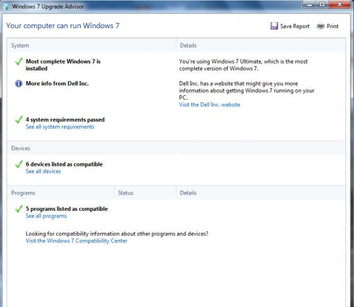

Please humor me and check Windows 7 Update Advisor on your computer just to be sure there are no problems identified: Free Download PC Upgrade Advisor Windows 7 Hardware Programs Issues. Please send me a screenshot or a file copy (if it has the option to create one) of the results.
Thanks!

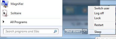

P.S. What method or methods have you tried to put your computer to sleep? I know several and before suggesting anything, I'd like to know how you do it now and what other methods (if any) you have tried. You say the scrren goes black, but it isn't really going to sleep. Besides how quickly it awakens, how do you know that? Can you hear the hard drive spinning or the power supply fan blowing or see any lights indicating that the hard drive is running or anything? When did this "won't go to sleep" problem start? Will it go into hibernation completely or does only the screen go black with that option as well?
    1920 x 1200 pixels
Thanks Lorien
My laptop information about upgrade Advisor is at the bottom.

" P.S. What method or methods have you tried to put your computer to sleep? I know several and before suggesting anything, I'd like to know how you do it now and what other methods (if any) you have tried. You say the scrren goes black, but it isn't really going to sleep. Besides how quickly it awakens, how do you know that? Can you hear the hard drive spinning or the power supply fan blowing or see any lights indicating that the hard drive is running or anything? When did this "won't go to sleep" problem start? Will it go into hibernation completely or does only the screen go black with that option as well? "
I go to sleep by
- Click Start -> Sleep
- Press Fn & Esc (Stand by)
When I click start or Press Fn & Esc, I know that the screen just turn off. Everything you mentioned is on. when I touch any keys or just touch the mouse the screen appears. That means, the laptop does not go to sleep. This problem happened soon after I just set up new Windows on my laptop.
I can't find the word hibernation near " Sleep, Switch off, Restart, Log off..."
So what is the main problem? Is it because I use Deepfreeze program on my laptop?

Hi rumdoh,
Your Windows Update Advisor looks exactly like mine did/does and we have very similar models. The key is the notice to check with Dell. There you'll find that it isn't compatible with Windows 7 (as I pointed out before with the links and despite the fact that it works for the most part). I not only confirmed it online, but also did so with Technical Support (I got a 5-year warranty when I purchased it). I strongly suspect this is the main problem (but I can't prove it).
I don't know enough about Deepfreeze to determine if it is a factor, but I suspect it isn't (though again, I can't prove that). You can always uninstall Deepfreeze and see if that resolves the problems or makes no difference - then you'll know for sure. Then just re-install it when done if it isn't the problem and leave it off if it is the problem.
As you have Windows 7, I'm not positive how to activate or deactivate hibernation as it probably is different than with Vista (but if similar, it wouldn't be where you looked but in Control Panel and Power Options and you'd have to change the settings to specify hibernation rather than sleep for certain actions and then let those actions occur (waiting or doing something) and see what happens). When done with the test, just change the settings back the way they were. Here are two articles that may help: Hibernate - Enable or Disable - Windows 7 Forums and Power Plan Settings - Change - Windows 7 Forums.
