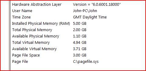

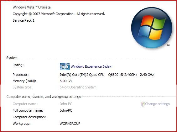

Eventually I got my PC returned and they had put 5 MB of RAM in ....

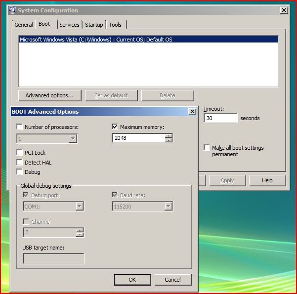

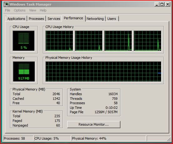

The problem is my PC can only see 2 GB of physical memory.
I have now got three 1 GB and one 2 GB of ram installed. My PC is preforming worse than ever.
I am stating to think my PC can only see or should i say use the 2 GB bar for some reason
Please see pictures below
I have even tried to change the system config but it will only allow me to select 2048 mb

In the BOOT Advanced Options, uncheck Maximum memory: and click OK. You will need to reboot for any changes to take effect. This should allow your system to utilise the full amount of memory installed.
As regards your other issue of performance, it is possible that this too is related to your RAM. Before, you had 4 x 1GB modules. These would have operated in dual-channel mode, 2 x 1GB per channel. Unfortunately, by changing the RAM and by having 3 x 1GB + 1 x 2GB modules installed, dual-channel mode will no longer be operative because the channels aren't balanced. The only way to restore this would be to balance the channels again (note that removing a 1GB module will NOT balance the channels as only 3 slots will then be occupied).
Have done that ...... None of the screen shots have changed as posted above. Instead of saying 2048mb now were I unticked it it just reads 0 now

I am still bewildered though why the likes of task manager reports only 2GB of physical ram.
That is correct, it just means that the memory is limited to the actual installed amount.
