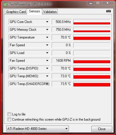

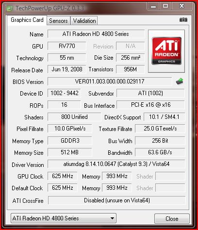

Hi Incarnate,
Run GPU-Z techPowerUp! :: Download TechPowerUp GPU-Z v0.3.3, note what it states for temperatures, GPU load, and, fan RPM on the "Sensors" tab. If you can, post an image of the results here. He's what mine looks like...
Also as has been mentioned, remove and reinstall the drivers. If you still have such high temps while idling, then your card could be going bad.
I will say ttoday's video cards run on the hot side, even at idle speeds, notice my lil' ol' 4850 running around 70 idle! And those are acknowledged normal temps at idle!!! However, I'm not sure if 90 isn't a little to even for a 4870x2. I haven't looked to see what the normal temps on that cards is though.

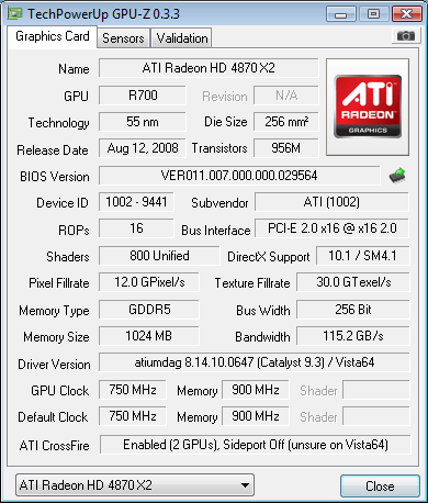

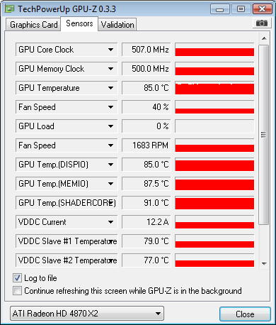

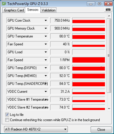

This is the 1.st. Gpu
2.nd. Gpu
I've just done a test with GPU-Z. It seems that it reads the fan speed to be 40%, but thats not correct. CCC tells me the fan speed is 27%. I've manually overriden the fan speed to 75%, GPU-Z still reads it to be 40%. So could it be a sensor gone bad, or is gpu-z not reading i right?
