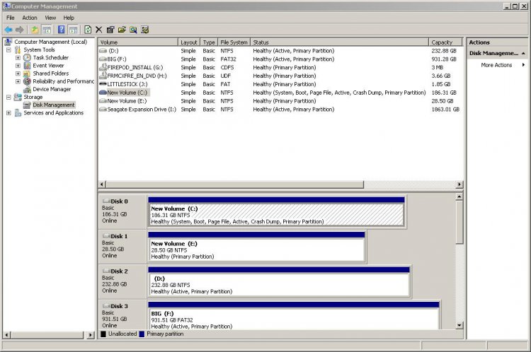

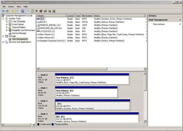

OK... Re-installed Vistax64 on the old corrupted-but-now-reformatted disk just so i could have a look around after my Partition Wizard adventures. For the sake of clarity let me call that installation the OD version (Old Drive Installation) This meant i had two installations of the same OS on my computer again; the OD Version and the ND version (New Drive installation which i installed after the original C Drive started melting down.
However, rather than detecting the two OS's and giving me a multi boot option the system only saw the OD version. Then - after a coupla hours in the desert, trying to figure out what to do, and without me doing anything at all, Windows (after ignoring the ND version after several reboots via the install disk) suddenly decides the ND version is there, repairs it and makes it available.
Is this weird?
The end result is that I'm more or less back where I was before with two OS's and a hard drive i'm not sure if i can reformat. I'm feeling a tad cautious about all this now. And understandably so i'd think.
Attached is the new screen capture of Disk Management. Does it look like Drive D (with the OD version on it) can be safely reformatted now?
Sorry for the peskiness :)
Cheers
Mark

Looks to me like the d-drive is not is use. You should be able to reformat it. The problem before was that the bootloader was installed on the drive with the old OS since that was installed first. Hence the error you received after the reformat. Restoring the bootloader on the other install would have been tricky but doable if you have the correct expertise. You should have been able to restore the bootloader without reinstalling Windows though. You will still have 2 entries in your current bootloader though. To bypass it from the start menu type in msconfig, click on the boot tab, select the install you want to use, click on set as default, and set the timeout to 0. After that hit ok. If you feel up to it I know of a program that will remove the entry from the boot loader but it is an advanced program and if you do something wrong with it you will delete the boot loader or your OS's entry in the bootloader and end up with the same OS not found error.
