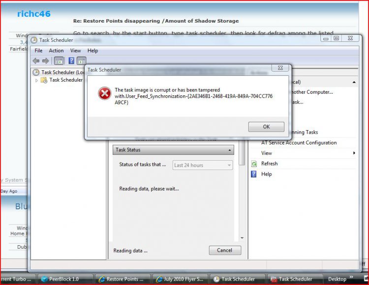

Hi Richard, and Brink, I am having the same problem,I put a system restore point in myself every so often,only to find my previous restore points have disappeared,I did not know that defragging would do that,i checked in the task scheduler and did not see any defragging listed,but i did get this popup box stating that a file is corrupt, see attachment,also i did change from avast to norton as it came free with comcast, and i think it does automatic defragging, could that be the culprit,i also ran sfc/scannow and that came up clean, any suggestions,thanks
This is a common problem with that RSS feed synchronization task. Here is the fix.
Open the Task Scheduler.
On the View Menu, select the 'Show Hidden Tasks' option.
In the left side menu, select 'Task Scheduler Library'.
In the Center section, right click the 'User_Feed_Synchronization' task and select Delete.
Exit the Task Scheduler.
Next, select Start / Accessories. Right click 'Command Prompt' and select the 'Run As Administrator' option.
Click 'Continue' on the UAC prompt.
In the command window, type the following command.
msfeedssync enable
Press ENTER.
This command will replace and refresh the 'User_Feed_Synchronization' task.
This will not affect the RSS Feeds you are subscribed to.
Hope This Helps,
Josh

Thanks Josh,your instructions was clear and precise, solved the problem with the popup box, will this also help with the restore points dissapearing,thanks patch41,
