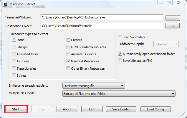

Please download the free Resource Extract (the normal, Unicode one) from here: ResourcesExtract - Extract files (bitmaps, icons, html files, and more) from dll files (Scroll down for the Download Link)
  • Create a new folder on your Desktop called IRISClient, or any other name you prefer.
  • Run Resource Extract.
  • In Resource Extract, uncheck every check-box checked by default. Put a check back in Manifest Resources and Automatically Open Destination Folder.
  • In FileName/WildCard, paste in C:\NoScrubs\NoScrubs IRIS\IRISClient.exe
  • In Destination Folder, navigate to the new folder on your Desktop.
  • Click Start.
As an example, my settings (but for a different .exe) would look like this:
Check in the folder on your Desktop. Hopefully, one or more .manifest files have been created (.manifest files can be opened with C:\Windows\notepad.exe, even if that is not the default program)

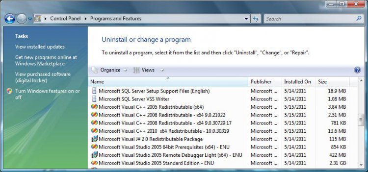

Hi Richard. Thanks again...I know this is getting a little frustrating for me, and I have the machine in front of me to try different things. I can just imagine how it is for you.
I will list what I have tried so far, and you can tell me if I have gone wrong somewhere.
1. Deleted, rebooted and reinstalled all x64 redist, rebooted again. I've included a picture called redist.jpg of what it looked like after I did this. Attempted to run program, no luck.
2. Clean boot. No luck.
3. Tried running without manifest.
4. Rechecked error log to see if the error message I was getting was the same or different from my first post, then realized I didn't include the error message I was getting. Here is the important parts of the error from Event Log.
1: C:\Windows\WinSxS\manifests\x86_microsoft.vc80.crt_1fc8b3b9a1e18e3b_8.0.50727.3053_none_d08d7bba442a9b36.manifest. Component 2: C:\NoScrubs\NoScrubs IRIS\Microsoft.VC80.CRT.MANIFEST
It looks like for some reason my system is trying to load 3053, instead of 4053.
5. Checked winsvs for 4053, to see if it existed. The only directory for 4053 is amd64_microsoft.vc80.crt_1fc8b3b9a1e18e3b_8.0.50727.4053_none_88e046c92fae6f57 Not sure if this is correct or not.
6. Checked version of files in 4053, they were in fact the .dlls needed, tried copying them to noscrubs folder, didn't work, either with or without the manifest.
7. Installed x86 versions of redist. I wasn't sure how the system would handle this, but wanted to try it just in case I needed them.
I left the system in clean load state through all of this. Nothing runs at startup that isn't microsoft and is essential to this process. Running in Safe Mode didn't work either.
I was running Vista Service pack 2 before reimagine, I'm back to Vista Service Pack 1. I am going to reinstall Service Pack 2 to eliminate any issues that may have been in Service Pack 1.
