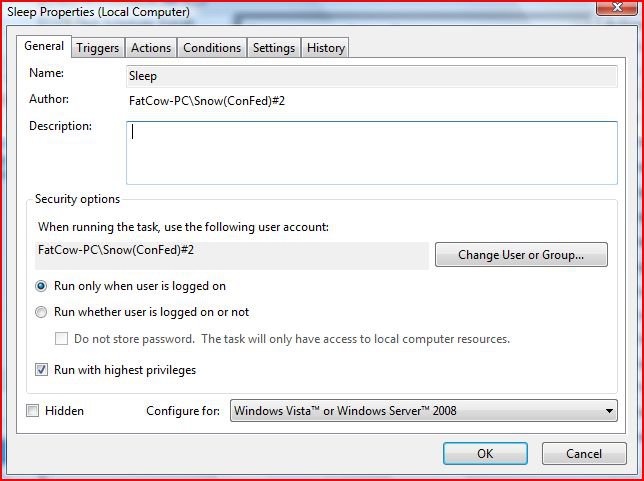

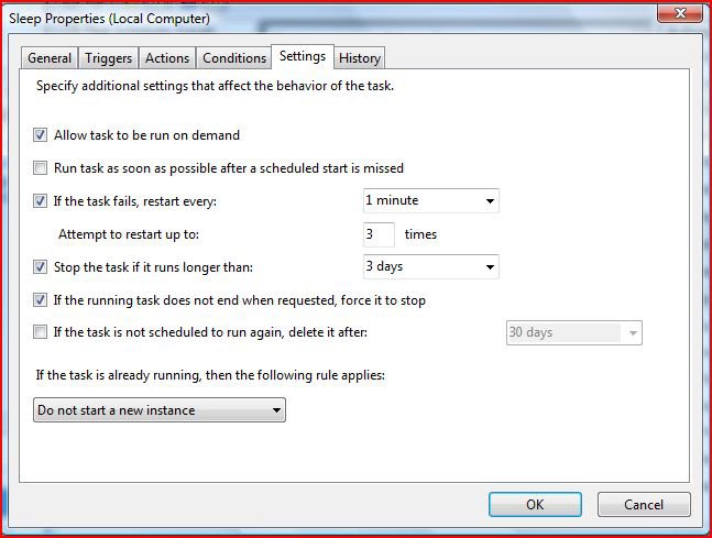

Well, Question not solved yet, but when the sleep.vbs runs via task manager, it brings up the options list on if you want to sleep, shutdown, hibernate, and lock. But if i manually click on sleep.vbs, it goes right to sleep.
How do I fix this?
    AMD
    ATI

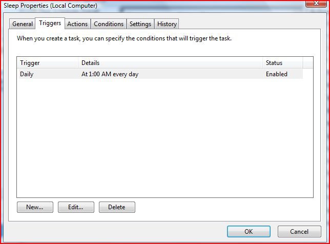

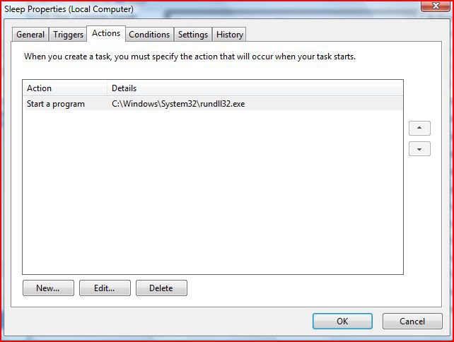

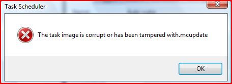

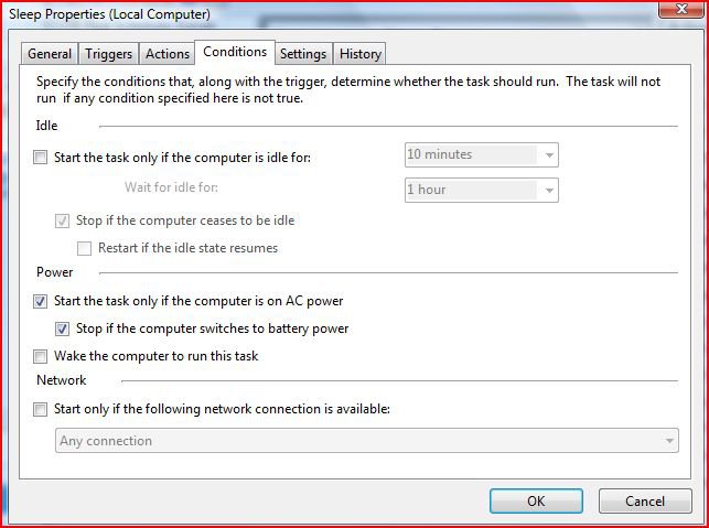

Thank's Brink. The Sleep shortcut now works but Task Manager still won't put my computer to sleep at 1am. I have it all set up right, so I'm confused. Although I get an error message when I start task manager, it should work, because my other tasks still work.
The sleep shortcut is in the folder where task scheduler looks for it.

I noticed the program path in the 2nd screenshot from the top on the left does not have the path to the shortcut.
I made the target "C:\Program Files\Sleep Shortcut\Sleep.lnk" with quotations, and HOPEFULLY it works.
Well, I'm confused. I think it needs to be a batch file for it to work.

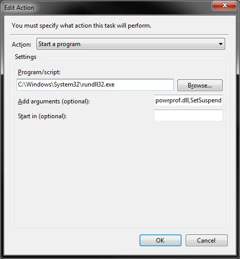

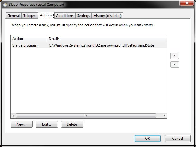

Ok Snow. I figured it out. :party:
Use the command below for the program to run in "Actions" like in the screenshot below.
C:\Windows\System32\rundll32.exe
Next, use this as the argument:
powrprof.dll,SetSuspendState
