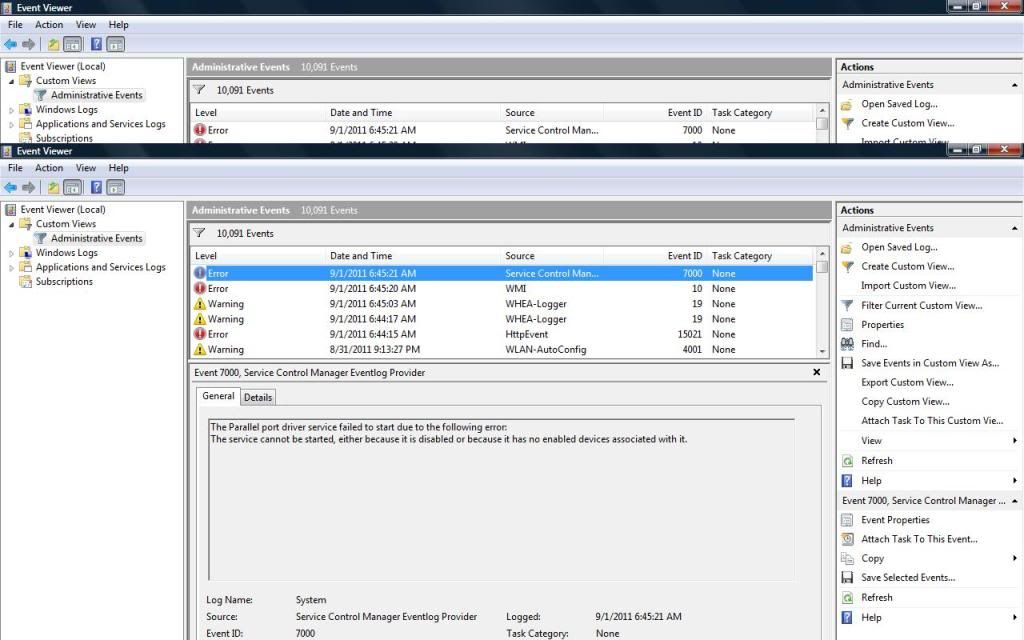

When you have the problem, check the time, then go to event viewer and give us a screen shot of the errors at that time.
this is what shows when the speakers arent available. The speakers worked at all recently so i dont have anything for when they do.

I'd be more concerned about that WMI event error rather than the Service control management error.
Here's a fix for it
Open an elevated command prompt (type command prompt in the search bar and right click and run as administrator) and type the following code
Code:
net stop winmgmt
DEL C:\Windows\System32\wbem\Repository\*.*
Reboot your system and let it idle out.
Hope this solves the event ID 10 on WMI

That solved that problem, but did nothing for the issue I am trying to solve...
