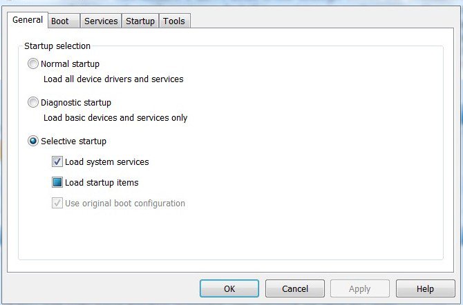

Hi y'all. Thanks in advance. I have a laptop with Vista Home Premium a couple years old but all up to date and everything. It was working fine, but I was messing around in the startup menu tonight and accidently cleared the wrong box. To make a long story short, after the machine restarted, nothing worked. I can't access system restore to fix it because it tells me that system restore isn't working, and that the volume shadow copy service isn't working. The error code on that is 0x81000202. Also the event log isn't working, apparently Windows Explorer isn't working, so much isn't working, and it won't connect to the wireless router so I've lost the Internet connection. I don't even know enough about the problem to say what exactly isn't working, but the machine is useless now. I've run every internal diagnostic I can find and the memory is fine, but something critical obviously stopped running when I cleared that box. I can't access the startup menu to reconfigure it either. Does anybody have any clues as to what I've done and how to fix it short of doing a clean install of the operating system? Thanks again.
Have you tried going into Safe Mode?
Startup and after the Bios screen , but before Windows starts loading, press F8.
Select Safe Mode - it takes a min. to get into it while it loads up.
You will only have limited graphics -you should be able to undo what you did from there.
I suspect you may have unticked this in msconfig . If so, tick it again, click Apply then Ok. Alternatively , Dot the Normal startup box at the top, click Apply and OK - then restart.
Hope it helps

Thank you very much friend S1W2. I did just what you suggested and it worked. I checked the normal startup option and everything is back on now, even the problem I was trying to troubleshoot in the first place, which was that the screensaver had stopped working. It works now too. Now I just have to figure out how to unplug all that unsecessary stuff in the start menu, and then I'll be right back where I started from, with the whole machine down again. lol. Thanks again sir.
