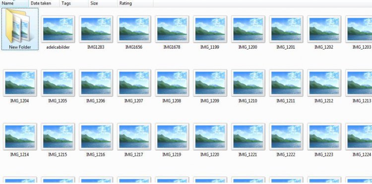

I have a problem, my folders and individual files used to show thumbnails but suddenly it stopped working. All I see is an icon from the default program.
I have read about it and tried to fix it in folder options, tried uniblue but I just can't figure it out why it's not working anymore.

I did everything the instructions told but I'm still not able to solve the problem. I'm so desperate:(
It's very funny, the second I open a folder I see some of the thumbnails but disappear in a moment.

Only photos, thumbnails of videos work normally. I just can't think of anything else that could be wrong. I've tried practically everything :(

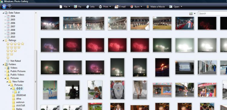

If I open Windows Photo Gallery, which opens all picture files on my PC, the thumbnails are shown normally, so I really don't understand what is going on :(

Yes, Windows Photo Gallery is set as default program for all picture types. But when I opened the Default programs settings the icon of Windows Photo Gallery was different than usually. And I also tried to install what you recommended but it didn't solve the problem :(
The strange thing is that when I open the Windows Photo Gallery thumbnails are shown but if I just to to a folder that contains pictures then I can't see thumbnails :(
